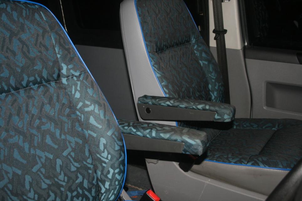

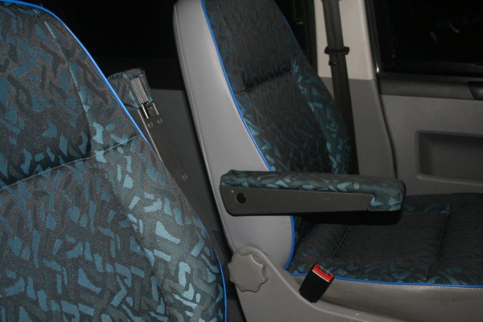

      I have fitted folding armrests to both front seats on both our T5,s I was lucky a friend of mine who owns his own Motor Trimming business on the Gold Coast used to do recover work for a motor home company and they used to supply different folding armrests from the standard ones which were on the seats . I was able to get the standard ones and retrim them and fit them myself with very little trouble all that was required was to drill one new hole in the side of the backrest frame and that was it the armrests are able to be adjusted in height with a simple knob on the underside . As for back support I also fitted some pump up lumbar supports these fit under the foam of the backrest and you can inflate and deflate them to the required setting with a small hand ball pump , they are real good for lower back support on long drives . The armrests cost me $15 each the pump up lumbar was about $35
