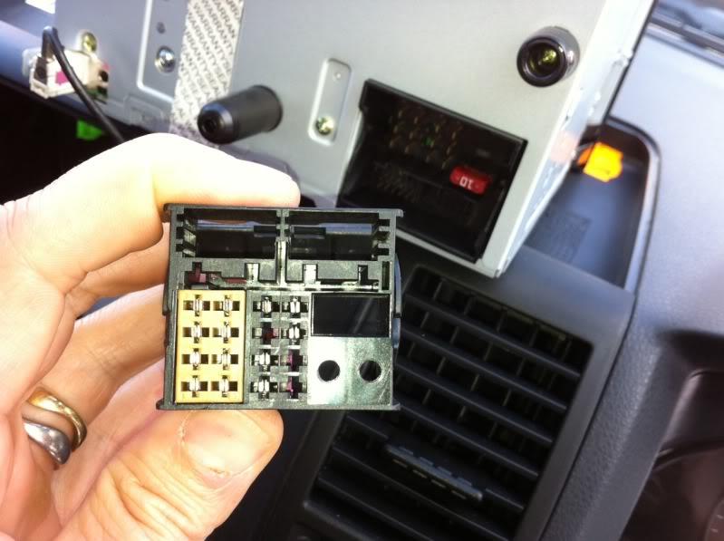

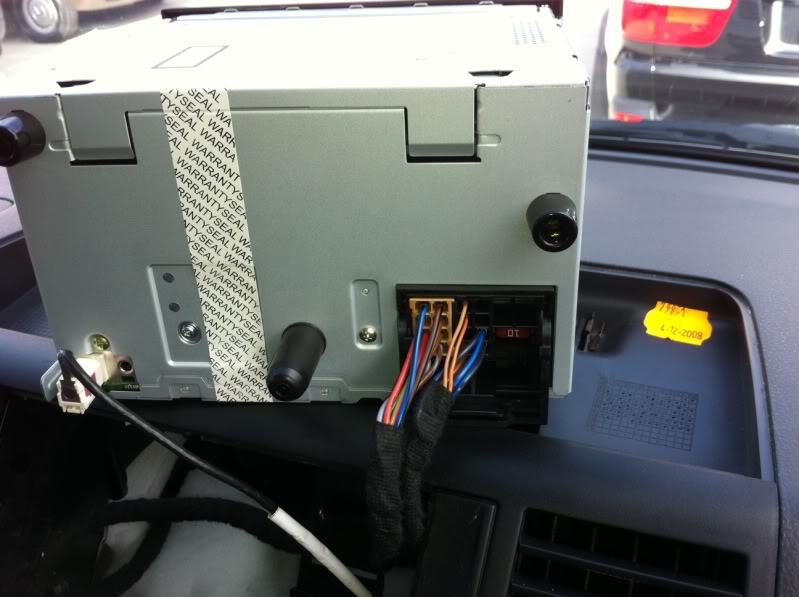

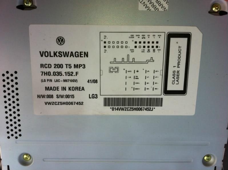

    Can anyone with some experience let me know if I will need the CanBus adapter when I fit an aftermarket radio. These are pictures of the factory unit.

    Factory radio MADE IN KOREA !!!!!!! Yes that connector is for can bus it shows it in the diagram the holes on the right are the speaker connections shown as LF - LF + RF - RF + and so on these can be plugged to your new unit but you may have to use some electrical spade connectors . I would suggest a CAN BUS connector with your new unit just in case . The older T5 has direct wiring that means there was an earth wire a continuous positive for memory an accessory wire plus lighting and some others that I now forget what they did If I get a chance I,ll have alook at mine and let you know .Howard
