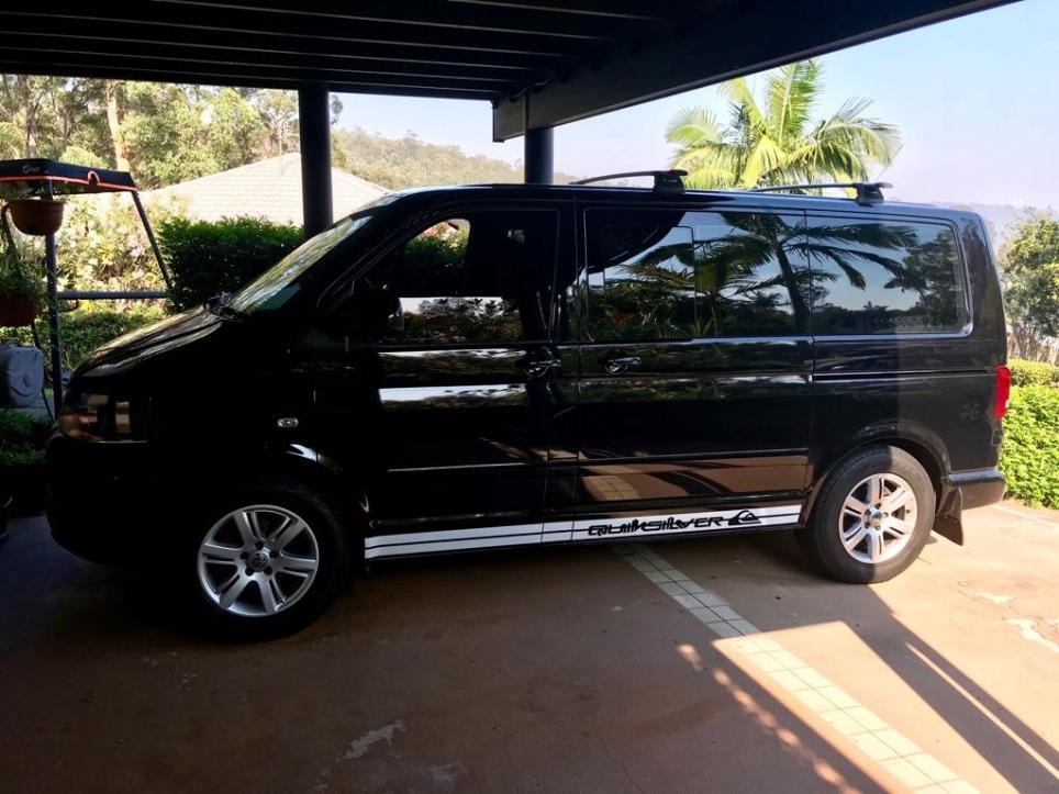

Hi ozgti, I fitted 255/55/18 twelve months ago, 12mm smaller than 245/65/17, only rubbing was on plastic under engine guard, fitted bolts both sides to pull guard inwards, problem solved, my first Toyo tyres, very pleased, done 40kkm already.
Remap engine supposedly more then 200hp, 180 kmh no problem, mechanic who did remap used software to recalibrate speedo according to Amarok 18” wheels.
Amarok wheels are et 49 or so. Multivan re et55. Looking at some steel wheels around et 35 or so. May need cutting and flares. But I'll say this, it's so much quieter and smoother than 245 35 19! Feels zippier too.
Yes I noticed a softer ride going from 45 to 55 profile, I can just imagine the difference going from 35 to 65 profile.
My speedo was reading about 10% slow with bigger wheels, choosing the bigger amarok wheels in computer the speedo is now gps accurate.
And Perth is now 50km closer to Esperance!
