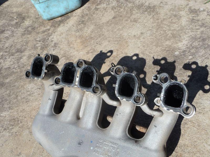

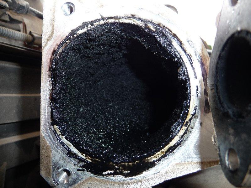

                      A few months back I removed the EGR valve assembly and partially cleaned into the intake manifold, as far as i dare reach with an old hacksaw blade.Lots of gunk.Blocked off the EGR on reassembly.
                      Thinking worse was further down, i have just recently removed the intake manifold to find it relatively clean.There was some sludge but not a lot.Most seemed to sit approx 50-100 mm back from intake ports on manifold, but still not a lot.
                      Soaked it in petrol and LPG flamed it afterwards
                      Removal of the manifold is easy once access is gained(the hard part).
                      132K kmA few months back I removed the EGR valve assembly and partially cleaned into the intake manifold...

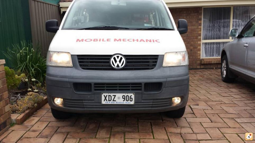

                            Fitted fog lights...

                              Looks cool I will be fitting a new front spot light flood light combo shortly into our new van I won't give any thing away just yet so stay tuned if it works it might give some others the same idea .
