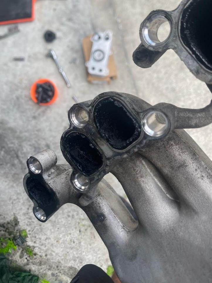

I’m in the process of changing the water pump and oil cooler and noticed serious amount of oily gunk built up on the intake manifold and on the intakes in the head. What’s the best way to clean the intakes on the head without removing it?
For a cam swap no fuel priming really necessary, just don't let the side mounted tandem fuel pump drain entirely. If it does, fill it back up with diesel best you can once back in place with a syringe or something. Air can be a pain to purge from the injector system, so simply avoid adding any as much as you can.
I had multiple issues at the same time, a straight cam and lifter cap swap should be straight forward, just make sure you line the old cam notch up with the head, drivers side with the lobes up at 10 and 2 o'clock, take pics, and put the new cam in exactly the same way. Timing is bloody everything.....Last edited by Greg Roles; 13-03-2023, 10:05 AM.2014 Skoda Yeti TDI Outdoor 4x4 | Audi Q3 CFGC repower | Darkside tune and Race Cams | Darkside dump pDPF | Wagner Comp IC | Snow Water Meth | Bilstein B6 H&R springs | Rays Homura 2x7 18 x 8" 255 Potenza Sports | Golf R subframe | Superpro sways and bushings | 034 engine mounts | MK6 GTI brakes |
I'd start with lots of degreaser, and use a scraper and then oven cleaner on the really baked on / can't reach stuff, only leaving it a few minutes tops, not the 10-20mins for an oven! Sodium Hydroxide reacts quickly with Aluminium and makes Hydrogen gas....Originally posted by summersky View PostI’m in the process of changing the water pump and oil cooler and noticed serious amount of oily gunk built up on the intake manifold and on the intakes in the head. What’s the best way to clean the intakes on the head without removing it?
Sent from my iPhone using Tapatalk2014 Skoda Yeti TDI Outdoor 4x4 | Audi Q3 CFGC repower | Darkside tune and Race Cams | Darkside dump pDPF | Wagner Comp IC | Snow Water Meth | Bilstein B6 H&R springs | Rays Homura 2x7 18 x 8" 255 Potenza Sports | Golf R subframe | Superpro sways and bushings | 034 engine mounts | MK6 GTI brakes |
Thanks Greg. I ended up using degreaser and a pressure washer for the intake and throttle body after scraping as much as possible.
As for the inlet ports on the head, lots of scraping and rubbing with a rag wet with thinners. Not perfect but certainly better than before.
Time to block or reduce that EGR, and add a decent catch can, even a China Provent 200 is better than nothing, I find only a thin, dry coat every year with that. Still needs a clean, but it's much easier.2014 Skoda Yeti TDI Outdoor 4x4 | Audi Q3 CFGC repower | Darkside tune and Race Cams | Darkside dump pDPF | Wagner Comp IC | Snow Water Meth | Bilstein B6 H&R springs | Rays Homura 2x7 18 x 8" 255 Potenza Sports | Golf R subframe | Superpro sways and bushings | 034 engine mounts | MK6 GTI brakes |
They’re next on my seemingly never ending list. Though the catch can seems easy enough to fit. After some brief research the EGR delete/reduce seems there’s more to it with regard to the ECU…Originally posted by Greg Roles View PostTime to block or reduce that EGR, and add a decent catch can, even a China Provent 200 is better than nothing, I find only a thin, dry coat every year with that. Still needs a clean, but it's much easier.
