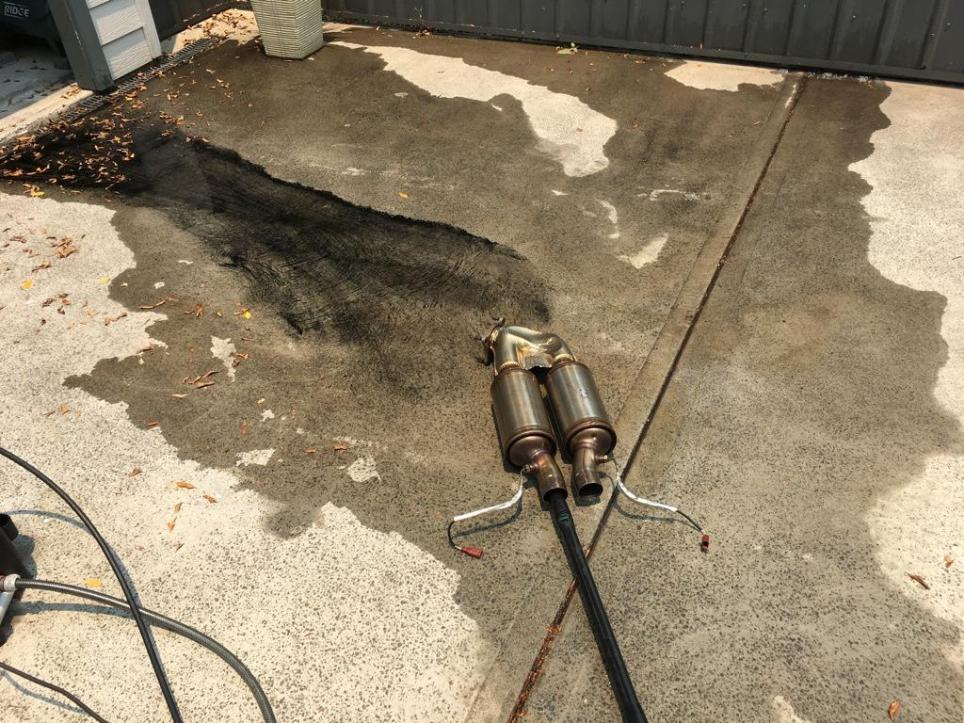

      I did a similar thing 2 months ago with my Audi SQ5 TDI, my DPF was blocked and the car was in limp mode. I removed the DPF and cleaned it with my Karcher, reinstalled the DPF and then had to use VCDS to reset all of the DPF values. All was fine after this and the car returned to normal.

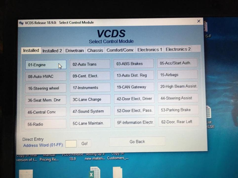

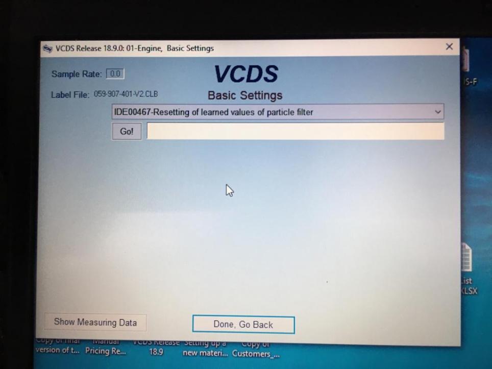

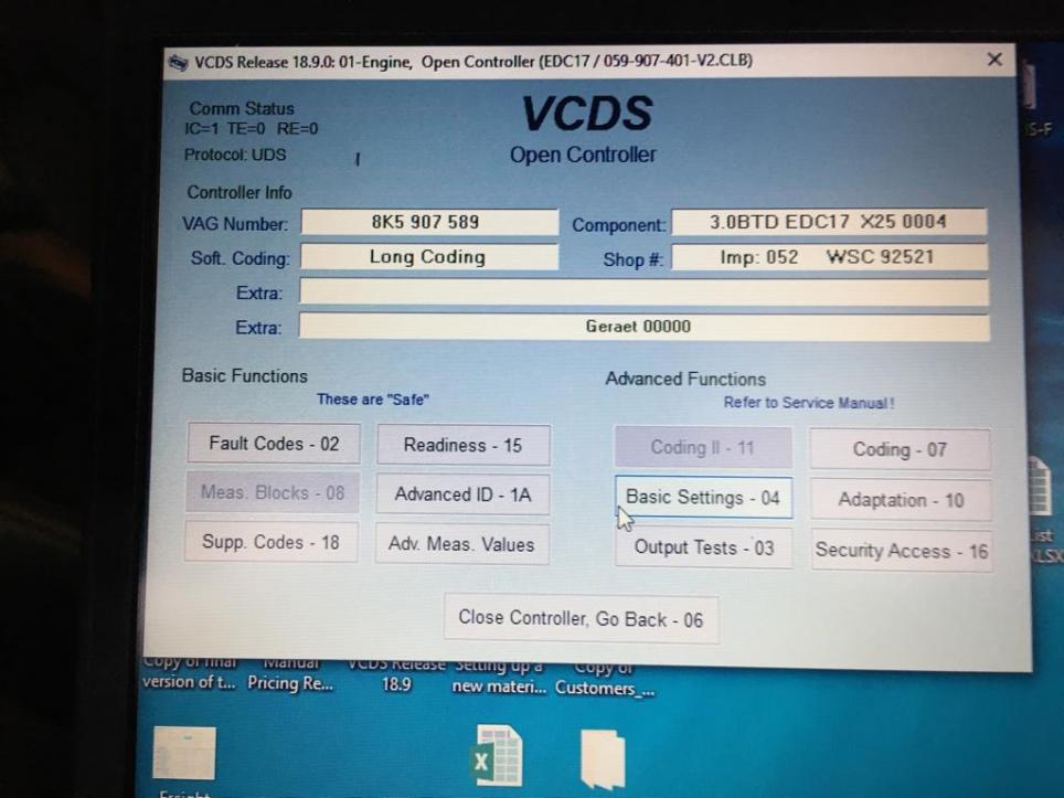

                  Ok here we go. As mentioned, you will need the VCDS (Ross Tech) cable and software and a Windows based laptop.
                  Select: 01-Engine
                  Select: Basic Settings-04
                  Select:
