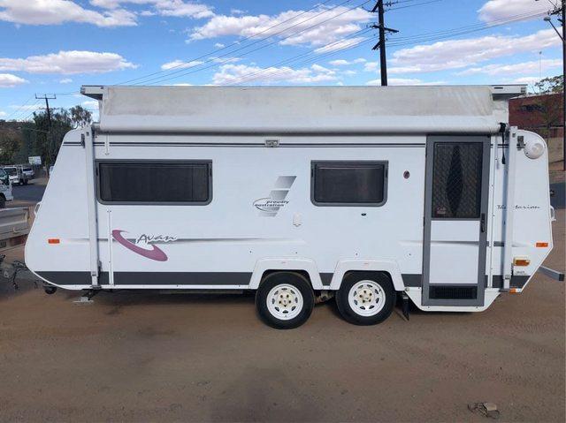

    i have bought a caravan from Alice Springs and need to tow it home(Tasmania)
    i have a diesel rodeo trayback which will kill it but would rather use my van(132 kw bi turbo) as its way more comfortable,and fuel efficient(coming from Tas)
    the numbers all add up but i need seat of the pants experience. i dont want to kill my van so would appreciate some feedback from those who tow a van regularly
    what do you think?
    thanks...russ

    Whats its towball weight and what is the Transporter's limit Bet it will be to light for the van as it will be at least 150kg

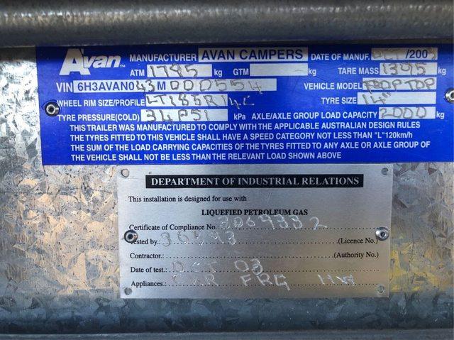

          Its quite simple really Whats the towball limit on the Transporter The vans will be at least 10% on that model Only got to look at how far back the axles are to realise it wont be light
          Here from a quick Google
          The Transporter Vans Towball weight allowance spec is 100Kg. The camper trailer's towball weight lists as 125Kg. The van's towing capacity is listed as 2000Kg braked
