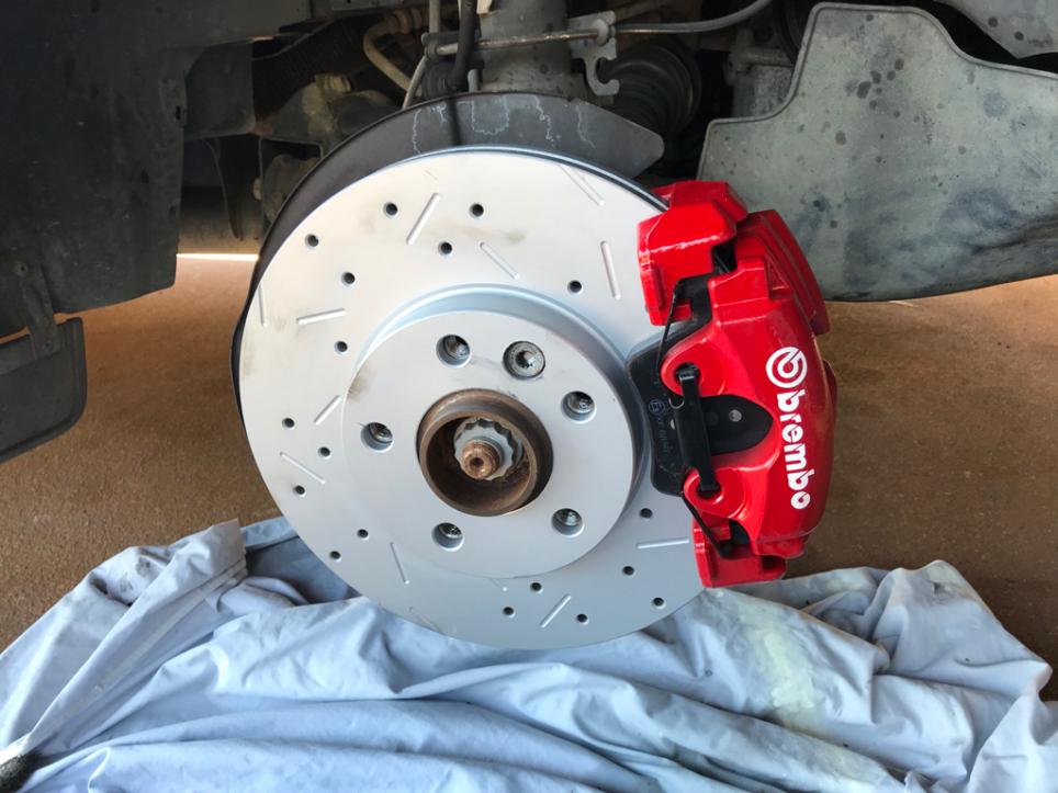

            So all went well on the disc & pad change,

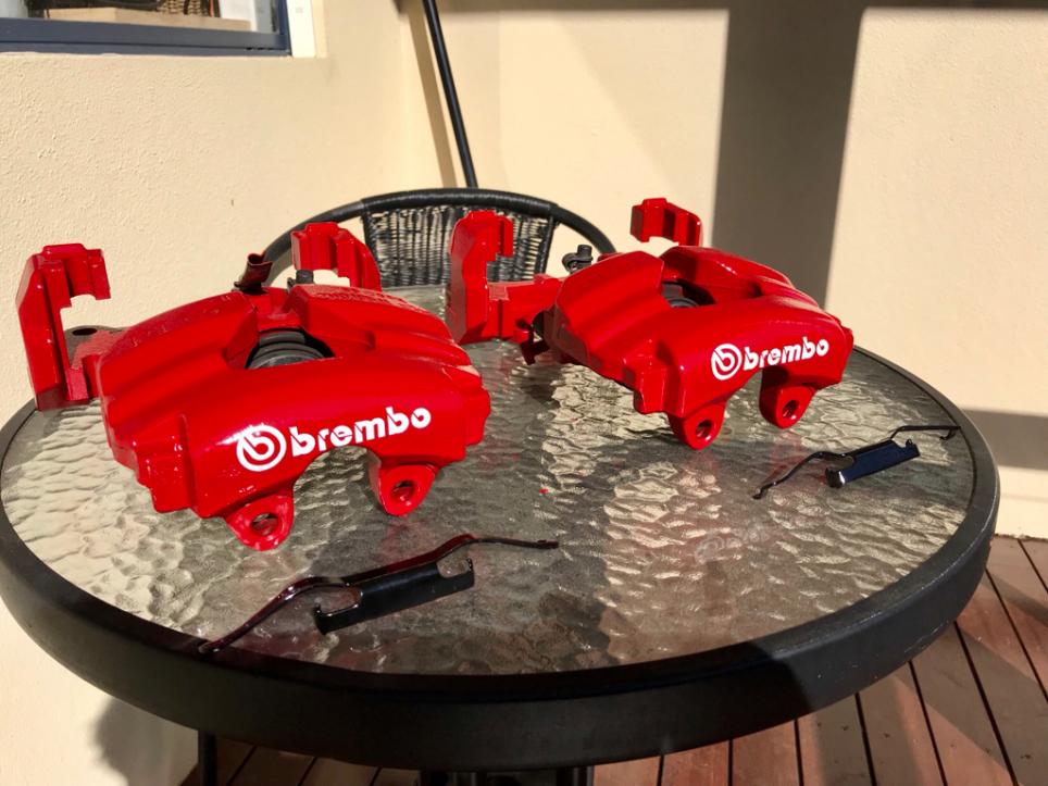

            I also undone the two front brake lines to take calipers off & gave really good clean & a paint.

              From the old days, a sinking pedal used to be a sign of failing seals in the master cylinder as the fluid would under pressure leak back past the seals causing the fluid to return to the reservoir . Nice paint work though !
