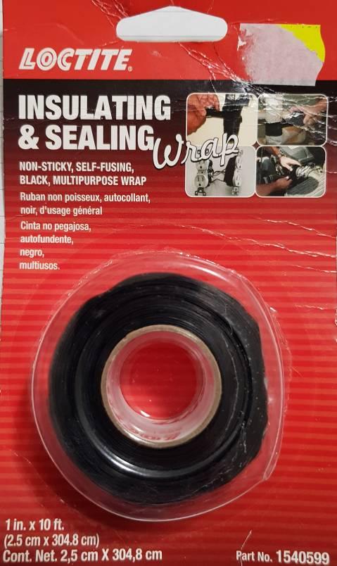

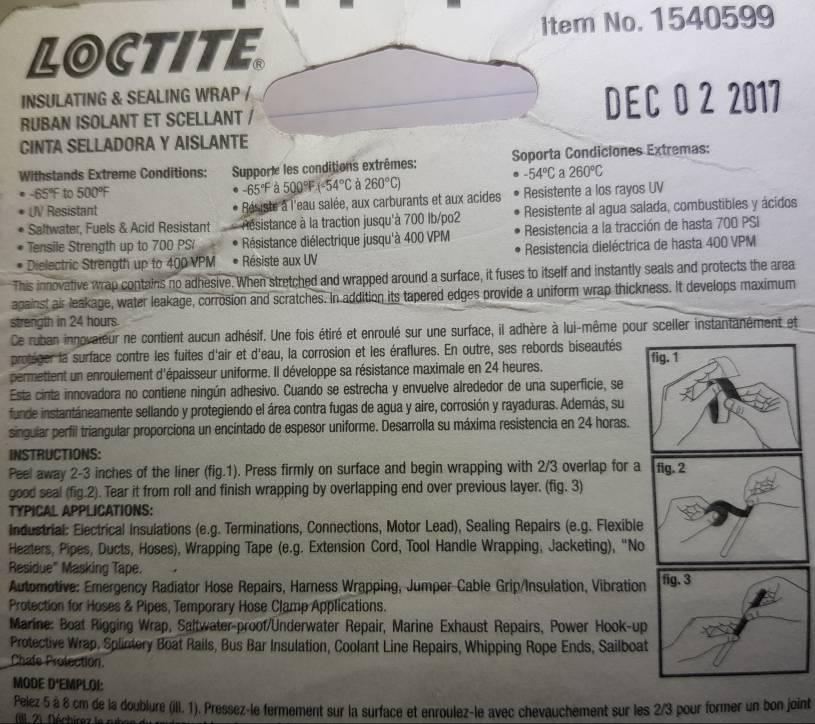

                You could use this inexpensive tape. It has tensile strength of 700psi and it's selffusing.

                  That would be good but I'd have to get the hose out to wrap it.
                  I could hardly get the phone in there for the pics!
                  Looks like a handy thing to have on the road though.
                  Loctite's version of fencing wire!

                      That silicone tape is fantastic stuff, I have used it quite a few times on leaking vac lines and it lasts years.

                        I haven't used it for this sort of repair before, but it is fantastic stuff. I think it'd be a good shot term fix. The best thing is it's flexibility and how it fuses to itself and you can wrap it tight.
