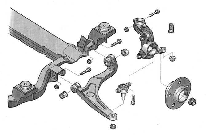

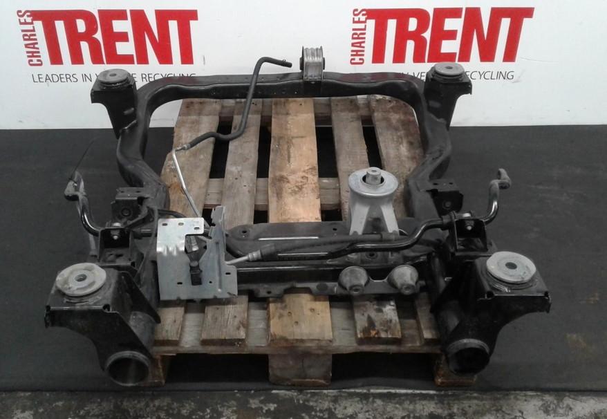

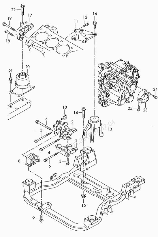

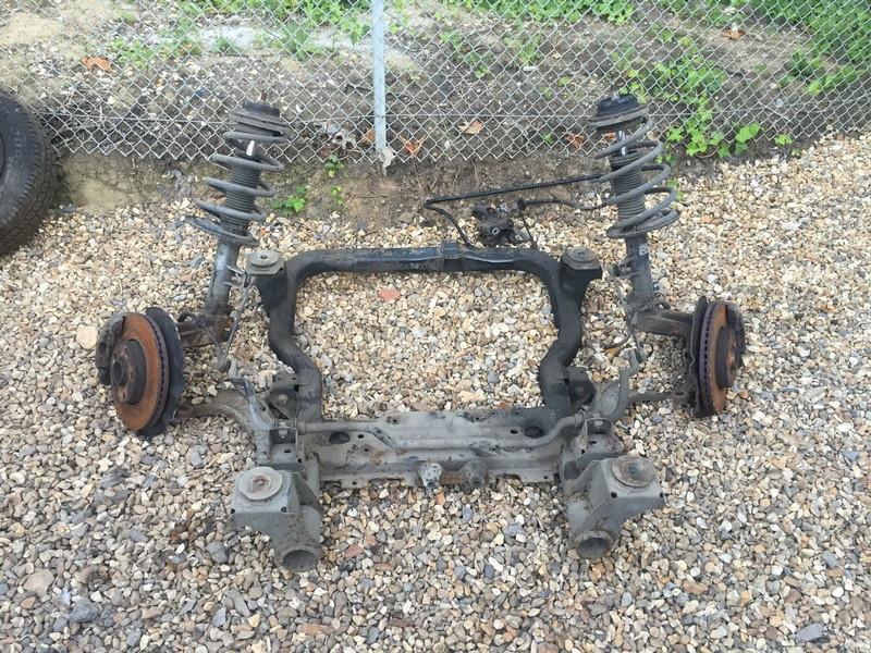

    So I'm trying to work out what else there is. The T5s front suspension attaches to the subframe. The subframe attaches to the chassis in four spots. The front and rear engine mounts attach to the sub frame while the right engine and gearbox mount attach to the chassis. The strut top of course is attached to the chassis. See reference pics below.
    I chucked the go pro under the car and there is a fair amount of movement between the subframe and the chassis when going up and down the gutter....though I wouldn't think it's enough to cause this. Could be though. Movement at the strut top wouldn't make much difference down at the hub.
    What else is there? Combination of worn subframe and engine mount bushes?
