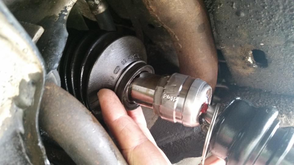

    I'm trying to undo the inner tie rods, as the steering rack needs to come out. is there a easy way to undo the tie rod at the rack end. some youtube clips show some type of tube spanner, while another uses a 32mm spanner. i have a 32mm spanner, but it is super loose, a 31mm would be better i think. it's also a crap position to get the spanner in!
    does anyone have any suggestions please!

      hmmm, i measured the nut at 30.3mm with my verniers. my 32mm spanner wants to roll over!

          well, i got them both, thanks to a pair of stillson's. the drivers side looks to have been replaced, as it's definately smaller than 32mm, and also has a smaller inner boot which goes over the ball joint. the passenger side looks to still be original, has the audi symbol on the boot, but, it is a 34mm gland, so i was never going to win with the 32mm spanner!
            You're right about the 34mm, I just went outside and checked what size the spanner was I had modified to work. It's a 32mm that's been embiggened to 34mm for this very purpose.
