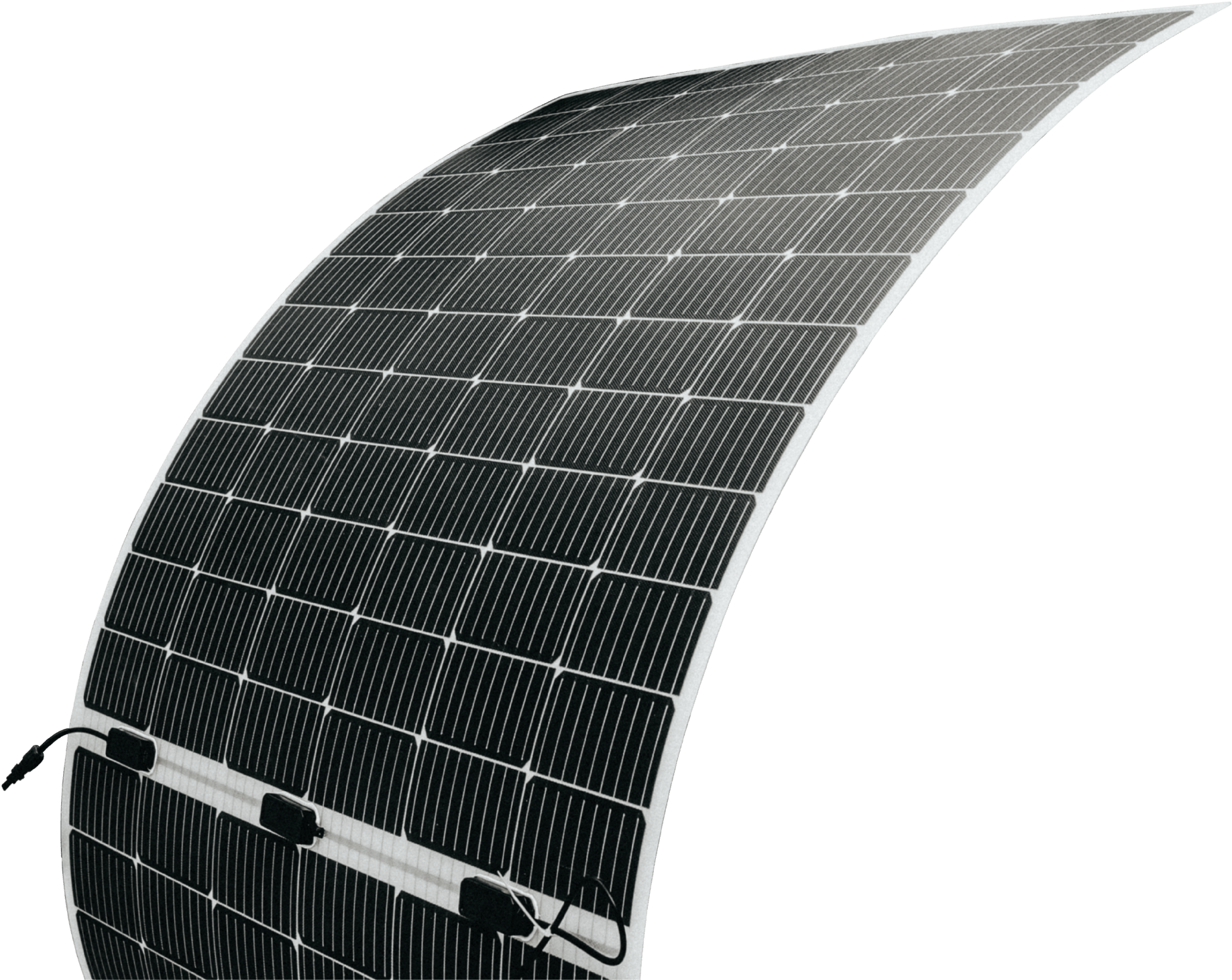

                  Hoddy, im not sure if you have looked at your solar panels, but i ended up going with the eArche flexible solar panel with the 6mm alum frame. (they have 3 different frame versions)
                  They were released late last year, and are made for Commercial and Residential dwelling use and come with a 10 year warranty.
                  I opened up the junction box on mine and it is completely sealed, a lot out there on eBay aren't.
                  I quite impressed with the quality, i ended up with the 180 watt version
