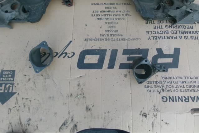

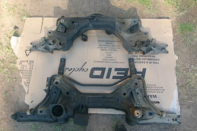

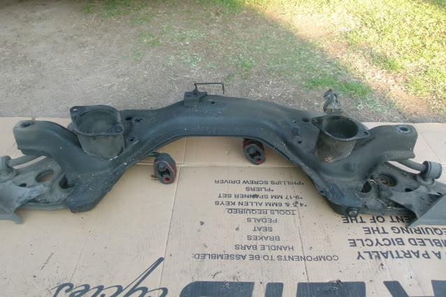

        Ok folks have an update, although it may seem little , this little is actually quite a lot. I picked up my Mk3 subframe which i bought to Cannab. Ive institched the 2 engine cradles for the engine mounts left rear and gearbox rear. bothe subframes are similar but narrower, so the cradles will be in a different spot and must measure point to point 600mm. The 6N2 subframe will be in and out a few times to find the right spot, next conundrum is the engine front mount. I wont be having a dogmount like other 6N conversions have. Im hoping to fit a mount to the front and have a front crossmember. This also will be custom. Not an easy platform to work with really. Ok i thought getting a side mount casting from an inlune audi would bolt up even if it meant fitting a canted oil filter housing which i also have but nope, no good, the bolt pattern on the 058 block is different from the 06A block. So stay tuned for that part.
        Anyway have a look at the pics of the latest
        Enjoy
        Here is the 2 subframes, rear 6N2 and front MK3
        Here is the cradle i detached from the Mk3 frame
        And here is the cradles roughly sitting on the 6N2 frame , you should get the general idea where my heads at
        Cheers

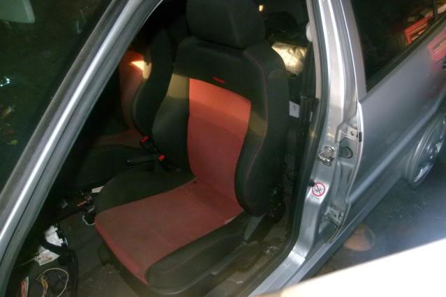

                    Looks like ill not fit the Alfa seats to this car but ill be far away from ditching them. Ive Scored a full set of MK4 Golf Gti Recaros, rocking horse seats. Right place right time, Stoked!!!! These seats are hotter than the preverbial. Im a massive Recaro fan and when these came up i instantly thought, they are going in the Polo!!!!

                        • MK4s came with a few different options, leather, recaros with black check , grey check and red check, mind you who cares they are cool . Havent seen many red check so couldnt resist, ive sat them in today and have to say im super stoked, i have to of course do some mods to fit them properly but when they are in the are gonna suit this car to the max. Happy daze.
                          Pics to come and im sure there will be some haters, it is a forum after all
                          Main thing is im happy , yeha!!!!! I got pics so ill load up what i can later

                              Here is a sneak peek at the front seats, u get the general idea, im fitting the whole set,
