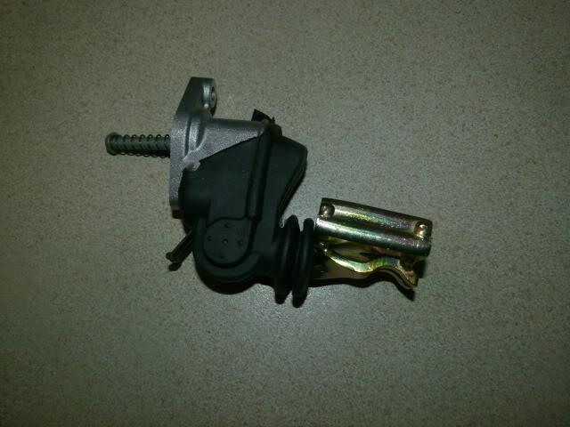

                  New part arrived today, cable to hyd conversion for the cable shift box i have.
                  Thats gonna work a treat. Anyway lots of more thought going into the thing and lots of ideas. Ive had the mill sitting in place using my newly bought 9N3 engine bracket, now on the hunt for a Polo Gti engine mount itself, the custom mounts were for an 058 block so water pump in the way on my 06A, not to worry will get round it. Bracket will need a possible shave. Engine is now on my stand and ive stripped off the manifolds, goodbye stock manifolds im sure you did your job well in the Golf you came from. Gearbox sits in ok without notching the chassis rail so far but my old shafts are still in there so ill get rid of them soon too once i free up some time, so much work on at the moment and this thing is teasing me now. Idea now is to get my ole faithful mk3 back on the road 1st then im into this
