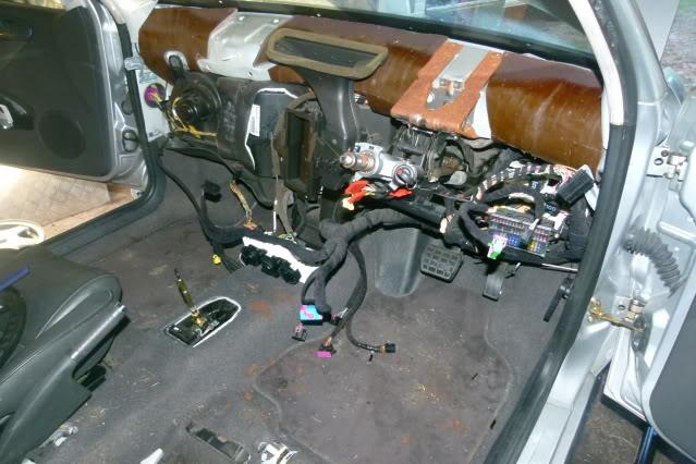

    Hi guys, had a top weekend and finshed it off with going to the RACQ motorfest which ended up with my wife wanting an MG, thats pretty good news though as i was brought up with them , roadsters and MGBs several and 2 factory V8s so ill be sent this way very easily. Anyway back to the topic at hand, had a spre hr or so and removed the dash, man these 6n2s have so many hidden screws!!! anyway all good she is out nice and clean. As you can see the Auto pedal set up and the auto shift, make the most of that guys, they are goooone!!! Bit dissapointed with my new pedal box, half of the stuff missing, ah well you get that.

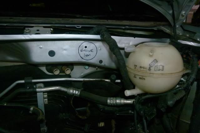

    I then spent some some time looking at it as you do, then decide why should i tear out all of the 6n2 ECU loom especially this one as its all looped into the Auto it had, no way what a task and for what?? so ive decided to go my own way and make it all still look stock. New loom location as shown
    Itll all tie in very nicely an look Mk4 gti stock. There is a few suprises coming though as my mounting idea has to happen now, got a gun fabricator gonna help me, im making a template and will unstitch the engine mount cradles from a Mk3 subframe and itll all be welded into the 6N2 frame, so itll be as rigid as a mofo. . Front mount instead of a dogbone now too FTW, only thing is how to?? first idea is seeing as i have a lot of Mk3 bits might modify the front crossmember from it and fab it into the 6N2 so it can take a front mount like a Mk3 or ill go the same as a Lupo brother in the Uk and weld in a custom crossmember of my own. Also scored a gun Mig at the weekend so thats gonna be mega handy im sure!!.

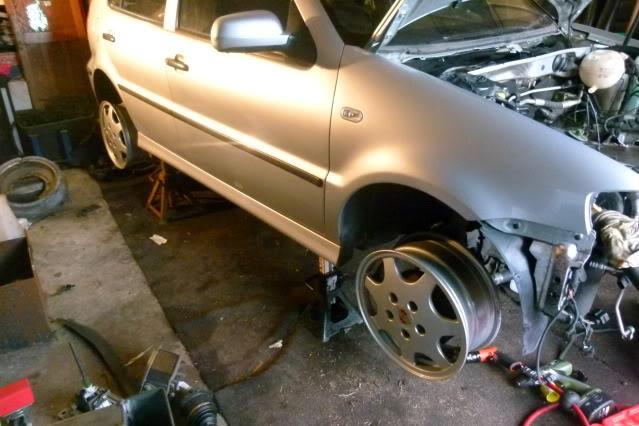

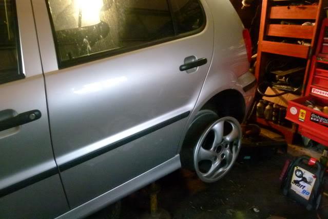

                  Ok here is some pics of the D90s test fitted minus tyres

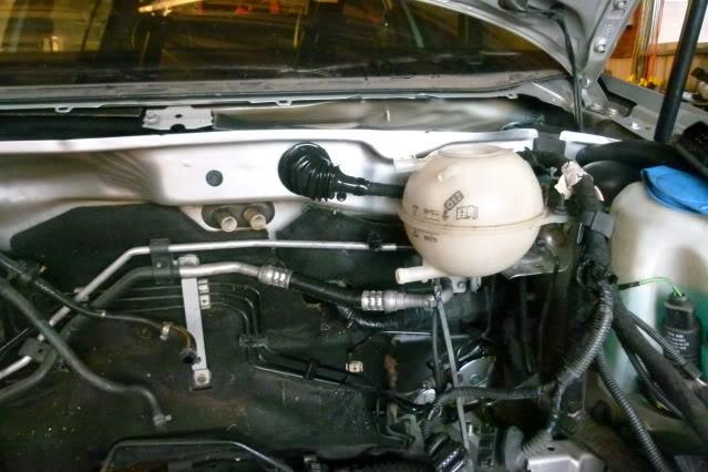

                  And now one half of the loom is in its new hime through the bulkhead, pretty happy with that. Other half will be routed tmw. Then ill make a start on terminating it to the original loom. New subframe here now too so will unstitch that. Ill most likely remove the 6n2 subframe tmw too and get it ready for its new mounts and task of holding the AGU lump.

                    Looking good, both sets of rims have a real match to the car from those shots.
                    Will it be sitting low?
                    • #85
                      Thanks mate i think i do prefer the D90s, and the staggered fitment im a fan of. Yeah itll be low, riding on coil overs to get the desired height, im also fitting a hybrid sump as that lump will be sitting low too.
                      Cheers

                          Do the twisties...although both awesome rims

                            I like the D90's, suit it nicely I think!

                              Yep agree on the wheels, i love them on this car, be a bit of stretch happening on the back but ah well we can break a few rules hey. Dont worry man ill finish this thing, When i get the mounts welded onto the 6N2 subframe ill be super happy then, its just at that stage where you go why did i do this?? its a massive task as its going into a totally different platform . Ive spent a few hrs today just looking at it summing up a couple of things. It could be chassis mounted with the special mounts i got, well with some pretty significant adjustments as they were for a 058 block and my AGU is a 06A block. But i just love the idea of having it on the subframe like a mk3, itll free up room and be heaps more rigid.

                                Managed to do a bit to the rocket today, sorry no pics yet maybe tmw, i got the AGU loom where i want it and all ready in the engine bay, Have another new hole to make for some of the loom into the inside of the car but pretty happy with the effort. Nicely done in conduit. Really trying to make it look like its meant to be there and that will add to the time. Looking at doing a little more tmw. Plans are to integrate the loom to the 6n2 loom. Done plenty of golfs and stuff this way but never anything like this so should be a challenge. Being a totally different platform makes it a shade cooler. Still havent got my Mk3 subframe , maybe this week and my new welder not here yet either. Ah well, all in time.
                                Cheers for now
                                Jmac
