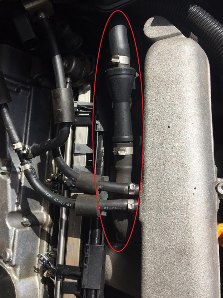

                          • #28
                            So while waiting for the laptop to charge and trial the cable/shareware software I changed the coils out (2.0t coils and ecs bling) and did the crc check on the intake
                            It ended up being a stuffed pipe connected to the intake manifold. Must have been getting progressively worse
                            All fixed!
                            Will still do the other things I was going to do anyway

                            • #29
                              All fixed!
                              WHich pipe Lee?
                              • #30
                                This one
                                It's proximity to cylinder 2 probably explains why that plug looked a bit leaner than the others
                                08 9n3 Polo GTI
