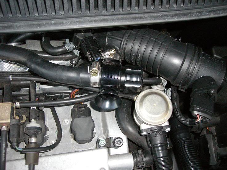

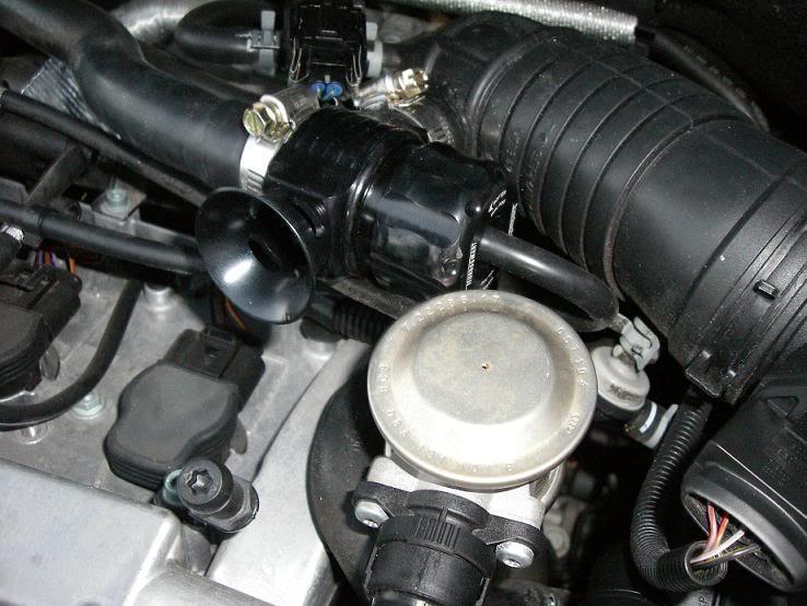

    hey all,
    i installed my new Turbosmart Kompact Series Dual Port BOV this afternoon. it took about 10 mins to install by myself with no extra bits, but because of the trumpet on one side can no longer put the engine cover back on
    i'm really happy with it as my turbo lag is not extended and it sounds great.
    SORRY ABOUT THE CRAP QUALITY OF VIDEO, A LOT LOUDER IN THE FLESH....CAN HEAR IT FROM WELL DOWN THE STREET
    and the video:

    I had the same one till it got lame.
    I was able to fit my engine cover on tho?

                I've got the same BOV and the engine cover went back in no worries.

                  already researched this jimmy, epc light wont come on cos it's dual port and it is pushing sufficient air back through the exhaust port to the TIP. it is interchangeable as well so if there is a problem it has a plug to convert it to full plumbback.

                      Ah dual port that makes sense mate. Do you have some info on that valve???? The reason the lamp comes on is as you probably well know is that there is unmetered air and it overcompensates gassing the o2 sensor. BUt the dual port sound good, still must have an element of unmetered air of course.
                      Be interested to have a look.

                              I got the Turbosmart Kompact Dual Port BOV fitted on my car. Its been 1 month and no idiot light has come up yet. I also have my engine cover fitted.
                              Turbosmart is an Australian Manufacturer of turbo performance products.
                              If you get one make sure its the 25mm as this will fit on a Polo. Mine is all black no silver/metal finish on the top of it as it is in the photo.
