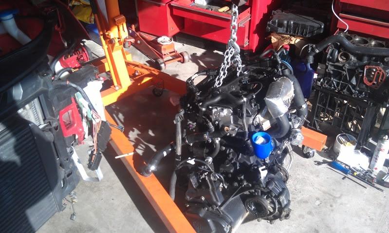

  • On the crane yesterday arvo

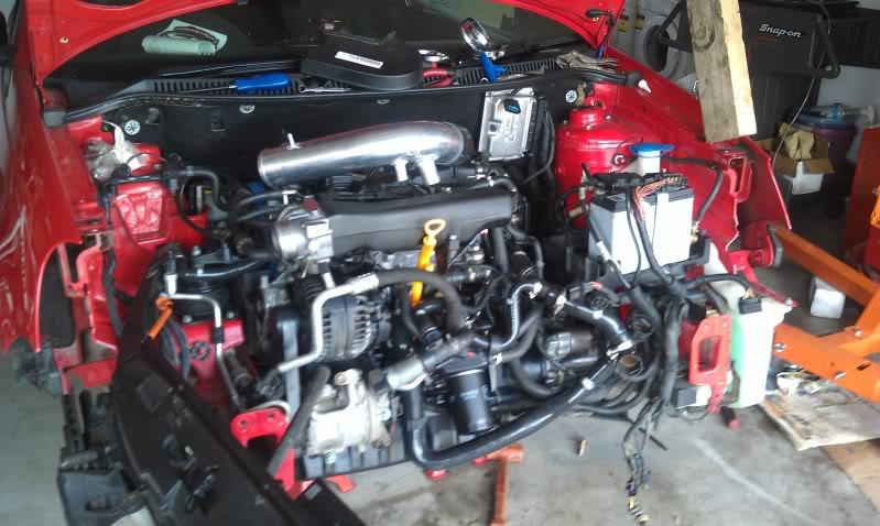

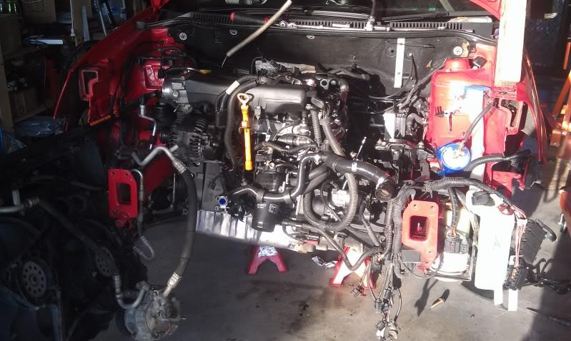

    This is where it's going

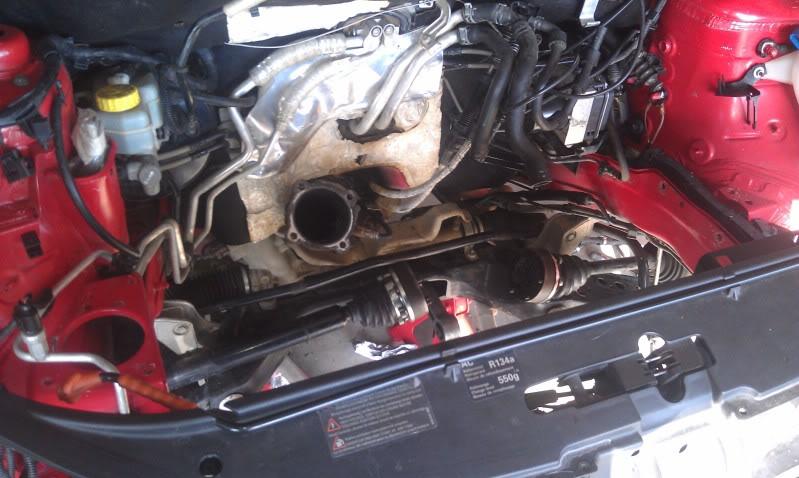

    Halfway in

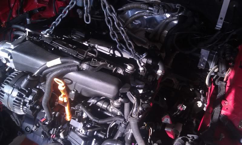

    On the mounts
    The new dog bone was a bugger to bolt up, I had to bring Mr Grinder out to play

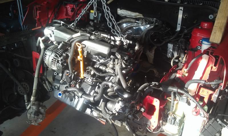

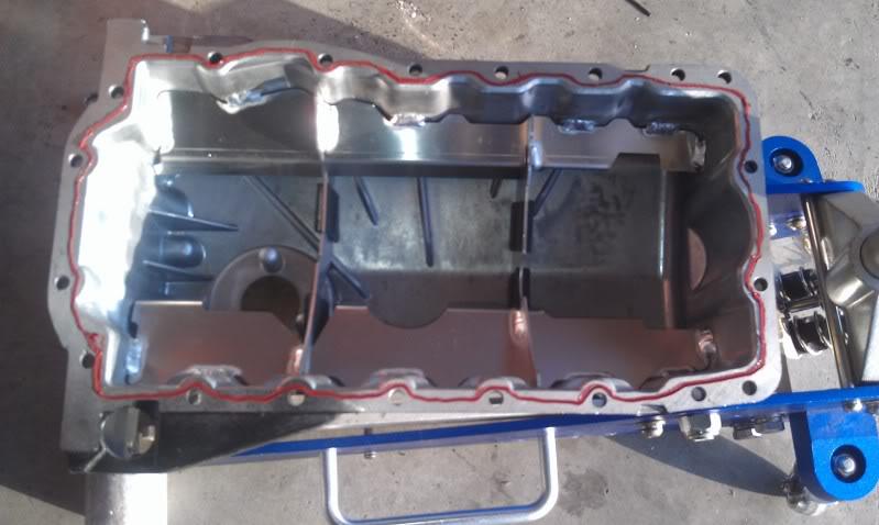

    Swapped in the Forge as I had been using an NA sump while the engine was on the floor
    Finishing up the new TIP

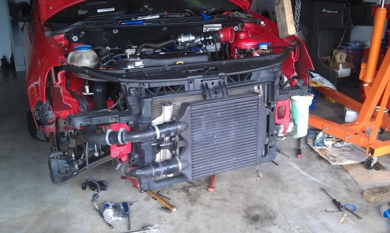

      I still wish I could squeeze in one of those Seat Sport FMICs, that thing look ha-uuge!
      Dark Grey Mk4 Golf, 1.8T GTI conversion, APR stage 1, stock air intake, FMIC, 3" to 2.5" Exhaust, FK AK Street Coils, Black 18" (Avant Garde M310's ?), tinted tails, ...
      • There would be plenty of better FMICs about mate. The reason for using one is the availability and no fitment issues. With the extra fettling we did on the outlet piping of Anthony's, I can see that there would be room for improvement in flow.

        I have been looking for some 30mm silicon pipes to do the MAD MAX DV properly, I ended up using one of the radiator hoses I took off to fit the Samco kit( Thanks Jesse ).

                    • Well after the oil change, it has become apparent that from the 3 oil level sensors on the property, I have picked the broken one to put in the Forge sump. FML It'll have to stay in until the next oil change.
