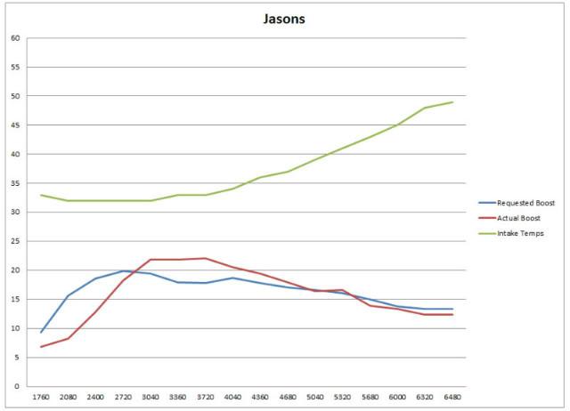

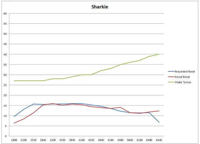

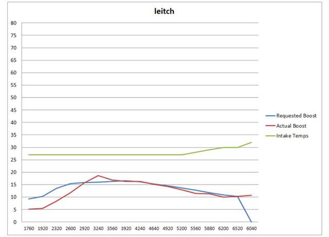

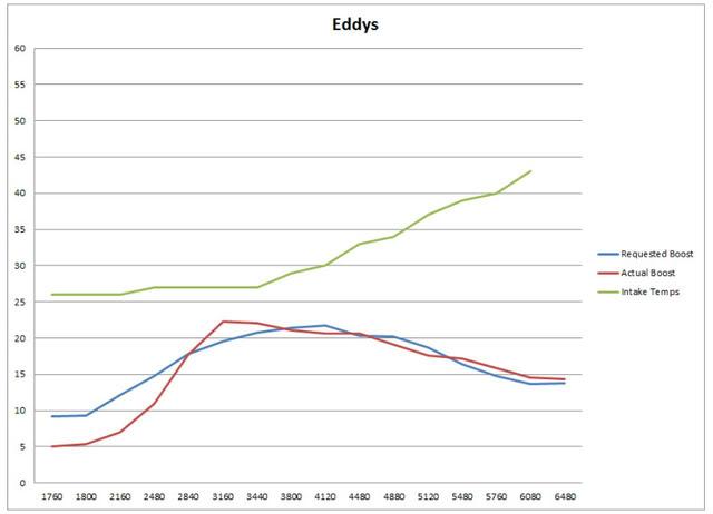

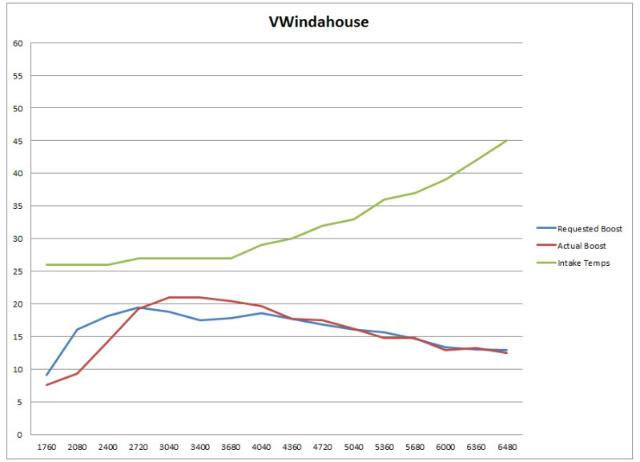

            Nice one Kenny! Guys I think there is a direct correlation better torque figures, requested boost levels and intake temps. Look at Eddy's, Jason and my torque figures
            Jason 366nm End intake temp 49
            Eddy 358nm End intake temp 44
            My 348nm End intake temp 45
            All had higher intake temps
            Look at the the cars with a lot less torque, Leitch, Sharkie
            Sharkie 312nm End intake temp 40
            Leitch 303nm End intake temp 32
            Intake temps are clearly not robbing any of the top 3 of power and especially torque. Also look at the requested boost figures from Sams graphs. The turbos are not working any where near as hard on Sharkies and Leitchs cars.
            So what other proof do we have now thanks to Kenny. Both a k03s and K04 polo increased by 6 and 7kw atw when changing from a forge intercooler as a result of better boost pressure from the new intercoolers.

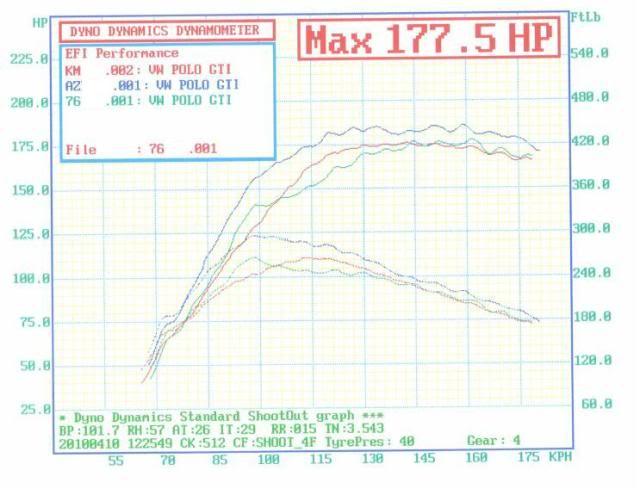

                    • #25

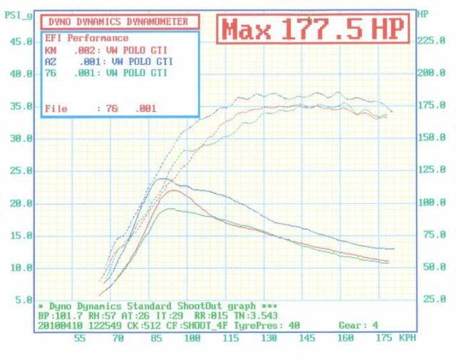

                      So here are the charts from a dyno day years ago where Eddy, Kenny and myself ran. The chart shows Kenny with a K04 and the Forge FMIC - Red line.
                      Look at the difference in boost between Eddy - Blue line and Kenny
                      It clearly shows a major loss in boost levels.
                      Now look at the difference in torque. Remember same APR tune so same requested boost.
                      I honestly don't know why anyone would purchase the Forge intercooler after seeing all these comparisons.

                          Data on the day: there was 5 degrees ambient difference when the Polo's were run so splitting differences of 5 - 10 degrees is pretty pointless. The obvious differences were what you see on the stock cars & heatsoak with the big temps.
                          On the dyno we only pull a 13 second power run (with a 4 second lead time), this does not stress the cars too much. If we wanted to really give the cars a workout, then we could do set / hold runs which emulate climbing a very big hill at full boost. We use this for different tuning / calibration methods, but it's very hard on the cars.
                          With some of the K03's pushing well over 20 PSI of boost, this would generate a huge amount of heat, even with the 100mph fan. Mind you, it would be closer to a race track type pull. This might show up some bigger intercooler differences, but it takes a lot more time, but it's really hard on the cars (and the clutch too).
                          On the requested vs actual boost, I wouldn't expect that to vary a huge amount on this test, one thing that is not in the data (I don't think so) is the wastegate duty cycle, and how hard the turbo is being pushed to make that requested boost.
                          Traditionally we try to hold WG Duty cycle to a nice, safe (for the hardware) ~ 75%. We can certainly make a file that pushes it a lot harder, but you sacrifice component life ultimately - there is no free ride to the top .

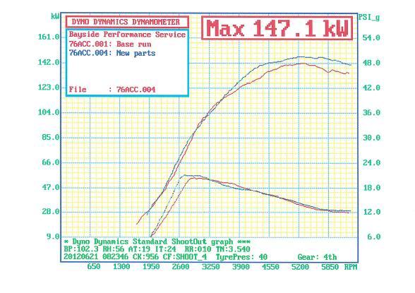

                              Sorry just to add some more evidence for the SEAT core over the Forge. Here is the difference in boost
                              Not only is the peak boost better but it builds so much quicker
