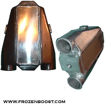

          Was that the frozen something brand / make?
          • #50
            Sharkie's is air/air
            Frozenboost is air/water(/air)

                You can find these all over eBay..
                Full Kit - https://www.frozenboost.com/product_...oducts_id=1006
