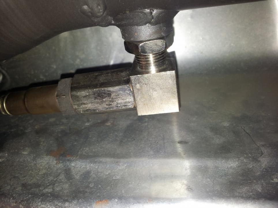

            Just an update with background so far
            •Added 3" downpipe with 200 cell cat with spacer to avoid CEL
            •CEL shows up 60 kms later.
            •Turns out the spacer is facing to the rear of the car. Switched to face towards the front of the car (drivers side) and clear fault code.
            •CEL shows up again 80kms later.
            •Disconnected the battery for 30 minutes, unplugged the MAF, reconnected everything again and checked the exhaust bolts.
            •CEL shows up 262kms later.
            Car awaiting to be looked at on the 24th March. Going to be smoked for boost leaks and a check over again. May be running to lean or to rich, for gods sakes, I have no idea.
            Will keep you all updated.

              • #22
                My spacer:
                • #23
                  Update
                  For some reason, and if you've had this issue before, please chime in...
                  Under hard acceleration and revs above 2,500rpm, the CEL never comes on. Always about 100kms after clearing the code, if I drive below 2,500rpm (generally in 4th gear) the code shows up on the dash.
                  Would logic tell you that if you're cruising under 2,500rpm, the air flowing through the exhaust system is not reaching the post cat sensor due to the spacer placing the sensor further from the exhaust? Therefore, the ECU reads a CAT deficiency or Bank 1 P1176 error code.
                  I think it's now time to start some logging. Can anyone in Sydney help me out here in terms of VAG logging and seeing if the sensor is infact no longer working properly?

                    Have you tried the car without a spacer at all?
                        Good question, no I haven't. From your experience have you heard anyone with a larger downpipe running no spacer with no CEL?
                        ---------- Post added at 03:01 PM ---------- Previous post was at 02:42 PM ----------
                        Is it possible to differentiate between pre and post cat o2 sensors?
                        The reason I'm asking is because probably the fabricator mixed up the o2 sensors. Front to rear and rear to front. If there is a way, can someone let me know?
                          The forward one is part number 06A 906 262 DK and the rear one 06A 906 262 DL
                          Gavin

                              Originally posted by pog View Post
                              Thanks Gavin, would this be actually written on the sensor?
                              Yeah it will be. Can't promise it will be easy to read though.
                              You might need an inspection mirror and a torch or take one out. 22mm they are.
                              Gavin
                              • #30
                                Gavin
                                What a champion! I'll jack the car up tonight and see if it's written on the sensor or the wiring. God forbid the exhaust shop have them mixed around!
                                Also, if they were mixed around, would that interfere with the idle, performance of the car? Sorry for the 21 questions.
