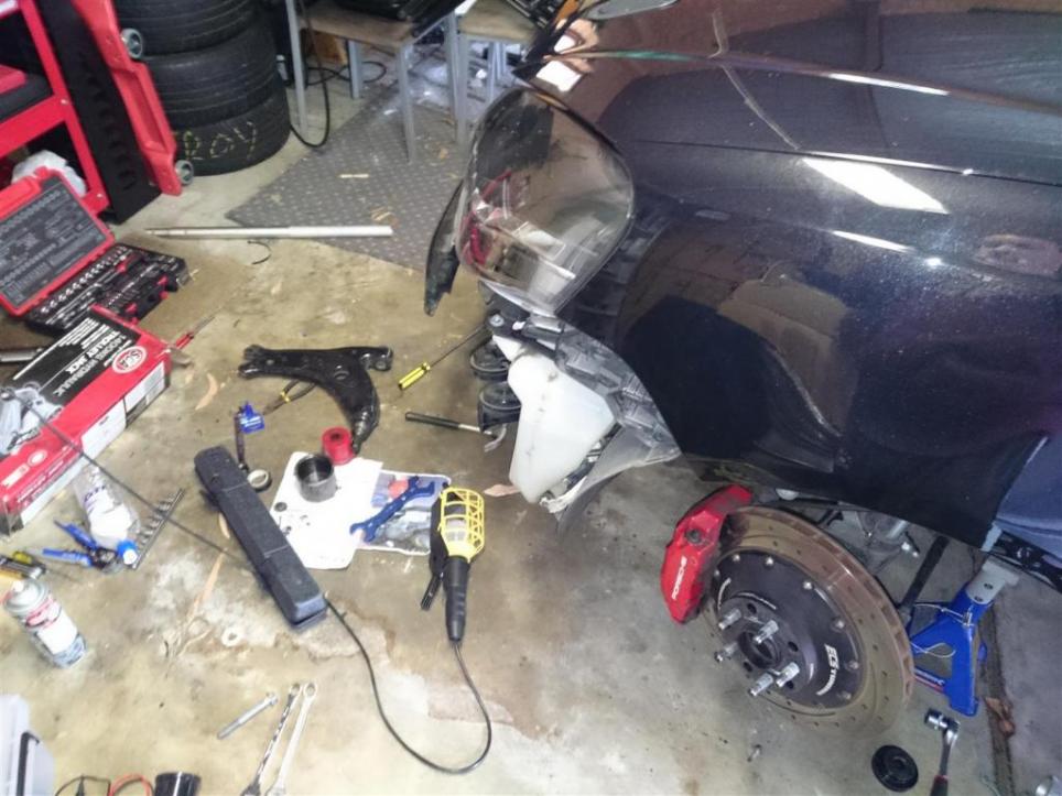

                        • So i spent the day playing with the control arms, not literally lol.
                          Changed the rear bushes to Superpro, with the anti lift and the front of the control arm i installed Powerflex Black Series.
                          It was a total pain in the arse to do, i don't know how many of you have done it yourselves, i am so sore right now from being under the car for so long. Thanks to Gavin for lending me his extraction/install tool which made the job easier
                          Car is amazing to drive now, feels totally different, im very happy

                          • Good stuff Troy, guessing it's stiffened it up a bit more? How's the vibration?
                            • Originally posted by Deadpool View Post
                              No vibration, I already had Whiteline control arm bushes in, yes it stiffens the front quite a bit, but its not a harsh feel
                              MODS- TOO MANY
                              • Turd job hey! I started mine in the driveway and then a 40 knot southerly complete with horizontal rain started. I was committed as I needed the car the next day so needless to say it was a freezing, drenched, miserable mechanical experience.
                                So can you feel a real world handling difference between the zero offset whitelines and the anti-lift setting you have now? What front LCA bushes were you running before when you had the whitelines in??
