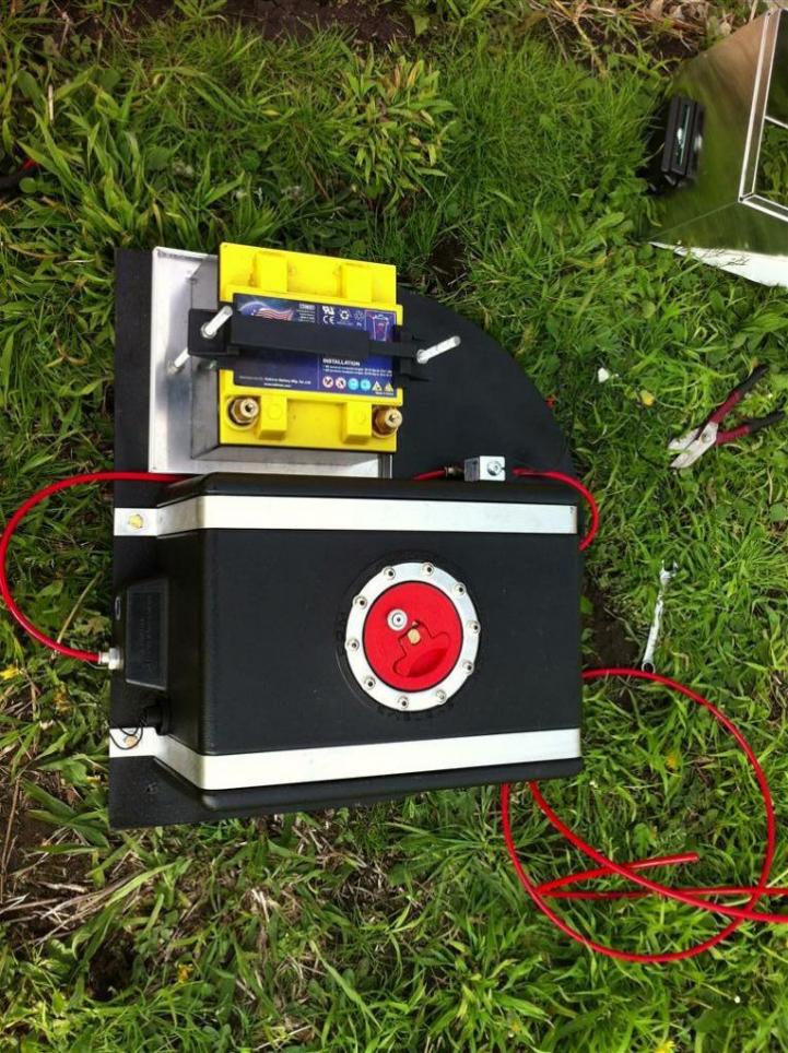

  • Water meth has been in for a while now (few months)
    Running the USRT throttle body plate/adapter, so its post throttle body
    I am only currently running water and it makes a huge difference. On a warm day it looses the sluggish feeling the car used to have.
    Looking forward to adding some more nozzles and playing with timing etc soon
    Oh its a Snow stage 2 kit, with optional solenoid, AEM filter and level sensor, with the bigger tank and USRT throttle adapter plate
    Here are a few pics
    Boot setup
    Alcohol Injection Systems Water Meth Methanol 3 Gallon Sumped Tank
