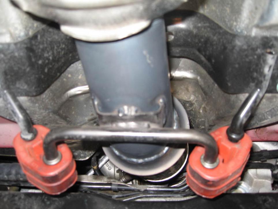

          As requested, here's a pic. Sorry it's not so good, but my ramps aren't very high

            Is that a support bracket in the middle? Also, yours is 3" right, what size is the standard dp?
            • #51
              Sorry it's a crappy pic. The standard dump is 2.25"; with the bends, it is less than that, of course.

                Im going to go do this tomorrow. Is there any chance you have anymore pictures of it?

                    Kai, sorry mate...I'll need to get it up on a hoist and I won't get a chance today. There's nothing too complex in the job for a good 'zorst shop. They simply cut and reuse the ball joint at the turbo, a mid flex joint as per the stock pipe, and cut into the cat so that the 3" pipe welds in smoothly. Oh, and retain the sensors. Tim
