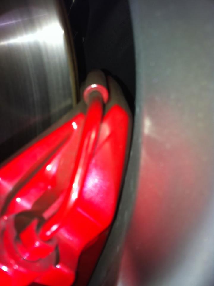

        Originally posted by Eddy View Post
        I'm looking at the set up you are talking about using the Porshe Monobloc along with the rear up grade.
        Me is hoping for a good outcome.
        You wont fit the brakes under the stock polo wheels, most 16's wont fit
        Also you have to space the wheel out quite far, so you could only run a Max of a 205 tyre

        • #64
          This is a stock Polo Gti 16 inch wheel
          MODS- TOO MANY

                  • #69
                    Hoyhoy.
                    Thanks bud, your right, me tried today with a template even with a 15mm spacer no go.
                    Hooroo.
                    • #70
                      Hoyhoy.
                      With a 16inch polo Gti, we had to use a 15mm spacer, but it is too close to the inside of the wheel, as the pic shows
                      MODS- TOO MANY
