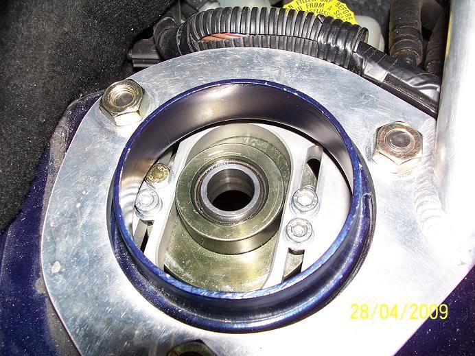

              • #82
                Originally posted by clubracer View Post
                I was considering using them as I've only managed to get 2 degrees neg on the front with the strut tops. I need just a touch more. Has anyone got any figures as to what degree of neg they produce?
                Hoyhoy.
                Seb I believe thats the name, correct or not.
                Anyway heres what I have custom made some time ago now.
                Thats the drivers side & where it is in the pic. it gives me -2degrees which I use for the street, if I move it to the bottom of the pic., it puts it back to standard of -1degree with a little bit of extra castor.
                Then for the track I move it to the top of the pic. it gives me -3.2degrees, hope thats helps ya.
                P.S. Those pillow ball bearings you see there are aircraft production which I'm replacing at the moment @ $300.00 for the pair, because there is a small clicking going on, I hope I'm right.

                • #83
                  awesome engineering, make me feel like a little kid the way I play...
