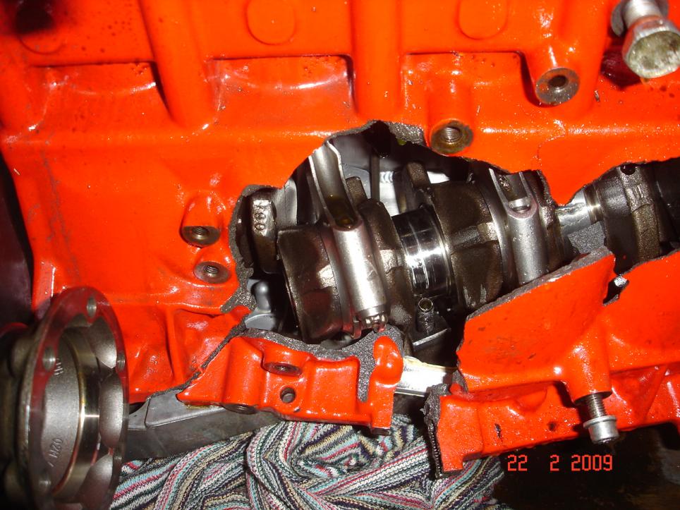

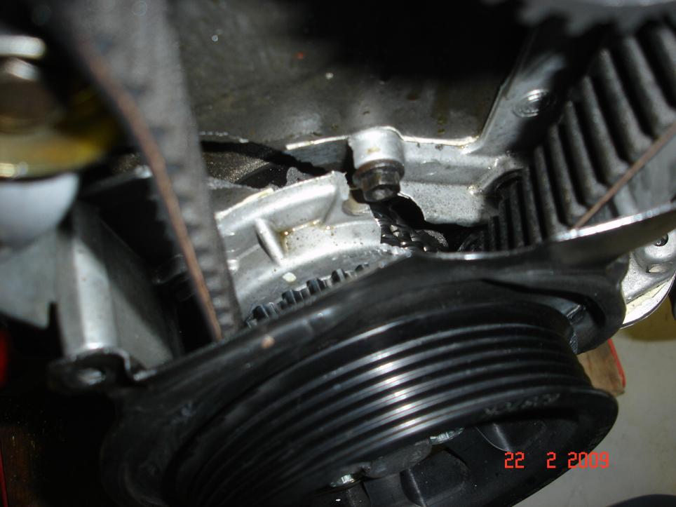

        • I'll give him a fiver for that cam belt if all the teeth are still on it!
          • Originally posted by h100vw View Post
            Just thinking that cam belt looks in good nick. I will bid up $5.50!
            • Originally posted by Polo GTEye N9 View Post
              I don't want it that much Al all yours.
