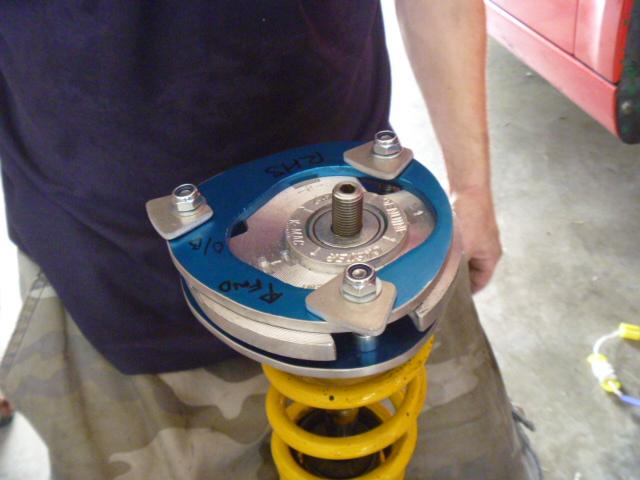

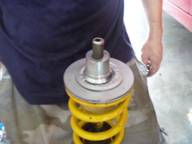

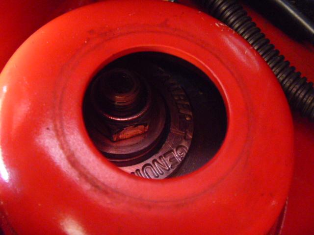

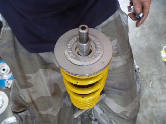

                          Got a bit further with the strut top mounts but sadly not 100% there yet. The issue shouldn't effect those with OEM shape springs I'm guessing so those with KW's should be ok. We managed to get them in this time thanks to Kevin knocking up the right ID spring seats for the FK's. Here is a little assembly guide as requested

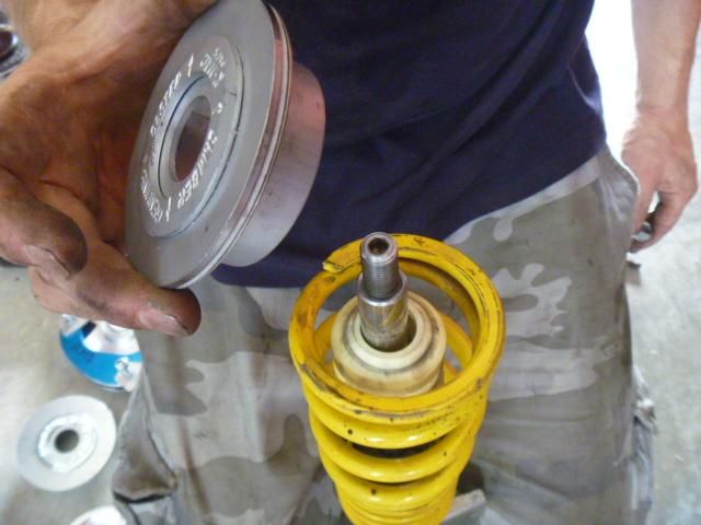

                          Spring seat goes onto the spring
                          Then the alloy top hat looking piece

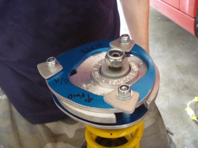

                          Then the top mount itself and the washer and finally the nut and the triangular washers if you don't have a strut brace

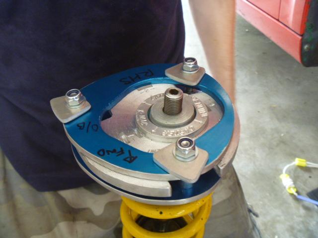

                          Then it should look something like this from the top
                          So the only issue I have is a loud creaking noise coming from the drivers side. Reason being the the FK springs run perpendicular (not bowed like the OEM springs) so the part of the spring seat that goes down into the spring is rubbing on the second coil. Kevin is knocking up some more seats for this which won't go as deep into the spring which should stop this. I believe all the group but mounts will now have this.

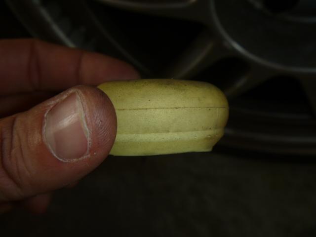

                          The only other thing we did is trim the bumpstops a little because the ride height is actually reduced slightly which is great for those looking for more lows

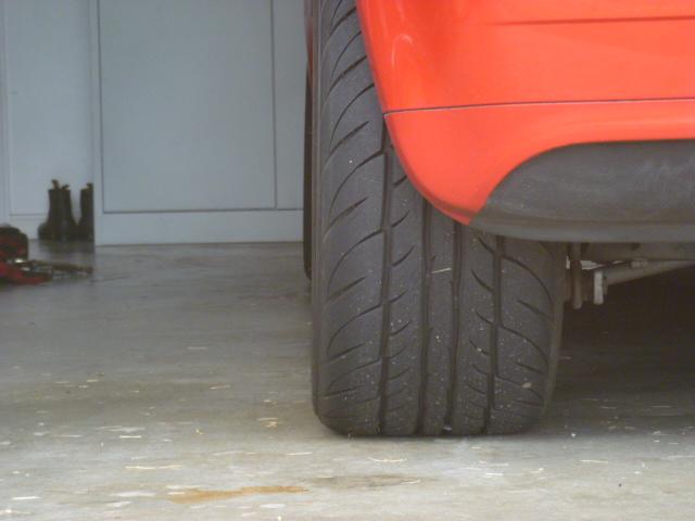

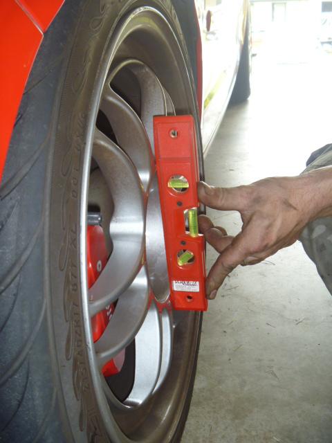

                          So just need the new seats and a good alignment and all done! We tested out the max negative camber setting for the drive home and it was a little too much without an alignment with some tramlining over 80kph but holy crap on that setting you can almost fit your fist between the top of the tyre and the guard Sorry don't have a photo of the extreme setting but here's one before it settled
                          photo from rear to front
                          Some ghetto aligning
