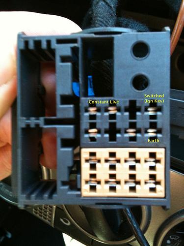

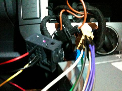

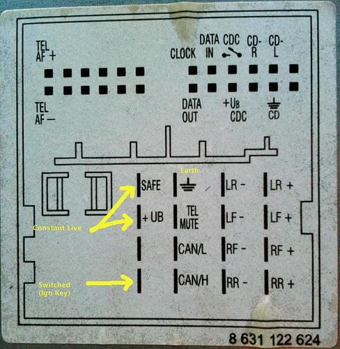

          • Originally posted by injidup View Post
            Here are two pics that should help:
            And a BlurryCam special of my not-so-professional connection with a cannibalised ISO connector:
            These wires have been tidied up now!
            Hope they're clear enough!
            Total cost (not including the head unit): Under $50 (Removal keys for RCD200, ISO Adapter, Fakra antenna adapter)
            Since disconnecting the power from the battery when fitting the subwoofer, I no longer have power when the key is in the ignition.
            Does anyone know if this needs to be reset somehow?
            No volts at the pin shown as "Switched" in my pic.

            • Maybe try plugging the RCD-200 back in to see if the system "relearns" keeping the power on?

                  • Will try that kaanage. Also, just had a service so the system was reset - maybe that will fix it too.
                    Something to try this weekend, anyway.

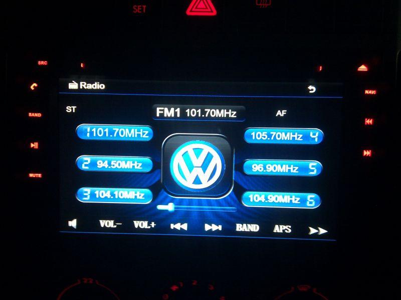

                      I wouldn't recommend it to a anyone really into high end car audio as the balance/audio control options are pretty limited and sound quality is on the side of average, but a very nice unit if you just need something with aux inputs, mp3 capability and the bonus of a GPS. Will try and get a pic of it in action one of these days, it's my partners car so I only really get to drive it on weekends.
                      Also, I've forgotten if I mentioned this earlier, but part of the rim/lip of the metal adapter plate they give you will have to be cut down with a set of tin snips or similar, otherwise the unit will stick out a few mm from the dash and not be nice and flush. Without the adapter plate the unit won't sit in the dash firmly or straight either. I have a feeling this adapter plate was designed more for the mkIV golf or previous polo somehow? I believe I only took off the bottom lip somehow (damn this goldfish memory of mine), here's a pic of the adapter fitting plate I'm talking about anyway:
                      Another issue I had was the unlock code for the user selected logo, was a bit worried at first when I got the unit and it was still displaying the stock Eonon logo instead of the VW logo with the logo menu asking for a password to change it.. fortunately I emailed Eonon and they got back to me with the code pretty quickly and looks pretty neat with the VW logo now!

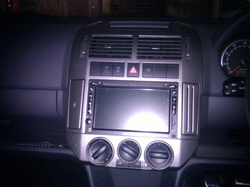

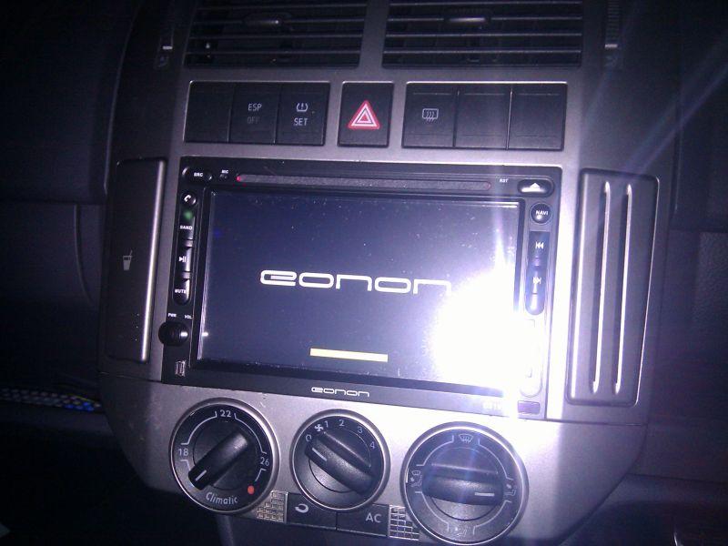

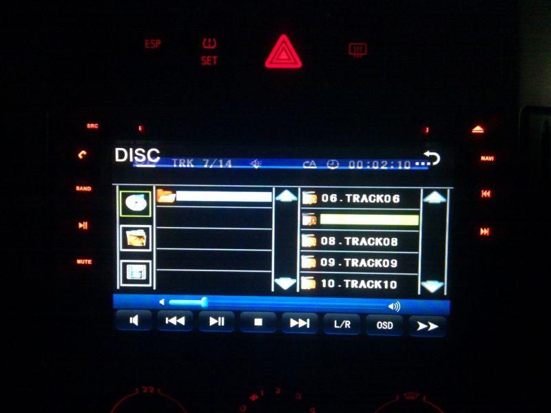

                              managed to take some pics and shoot a short vid of the unit on my phone last night - not the best quality but you get the idea..
                              The dust on the screen the first couple of images is from my botched attempt at applying anti glare film, I bought 7" film off ebay thinking it would be perfect fit, but had to run off after peeling off the backing to get a pair of scissors and cut a 5mm strip off the bottom of the film.. will definitely be measuring before the next time I put some film over it.
                              The eonon logo you see is when the unit powers on, not sure if you can change that, but you can change the radio's background logo to the vw one you see there.

                              • Mate thanks for that, the vid answered a lot of questions about the speed of the unit, its not much slower than the stock unit amazingly when loading Cd's, does it take long to turn the unit on?
                                Might put an order in for it on the weekend, how long did they take to send it to you?
                                Cheers
