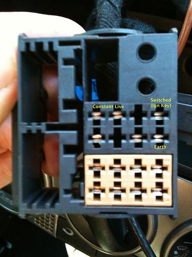

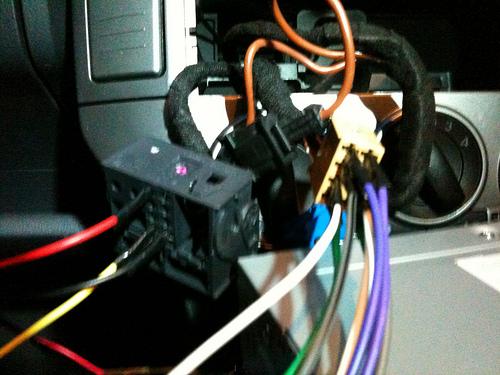

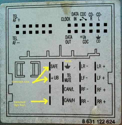

      Here are two pics that should help:
      And a BlurryCam special of my not-so-professional connection with a cannibalised ISO connector:
      These wires have been tidied up now!
      Hope they're clear enough!
      Total cost (not including the head unit): Under $50 (Removal keys for RCD200, ISO Adapter, Fakra antenna adapter)

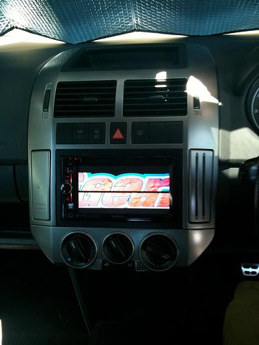

        Kenwood Head Unit Installed

        • #94
          that looks awesome, you have inspired me to burn more ca$h cheers

              Originally posted by injidup View Post
              Will grab the illumination feed (to dim the stereo when the lights are on) from the rear window heater switch as it's easier to get to than the aircon controls.
              So which lead to the rear window heater switch did you end up splicing into for the illumination feed?
              Resident grumpy old fart
              • #97
                |1 2 3 4|
                |- - - 5|
                Pin No. 3
                There are only 5 wires. 3 pins are not used.
                Hope that makes sense!

                • #98
                  Thanks. I was in the midst of measuring voltages when I was interrupted and never got back to it.
                  • #99
                    I think it only measures about 7volts, but it's enough for my Kenwood to use as a switch for the dimmer.
