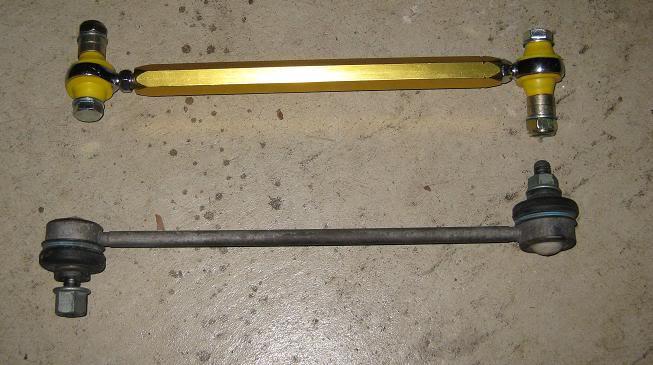

The whiteline product are designed to provide a firmer link between the suspension and the droplink. If you have removed the stock droplinks, you may have noticed they are very 'soft' and have a lot of play in them. This is fine and probably a good match for the rest of the stock suspension. With a stiffer front sway, the OEM links seemed to have some play in them which reduced the connection to the front sway sometimes.
I'm not sure if there would be much benefit when used with the stock front swaybar, but with the stiffer whiteline sway, I think they work very well.
So, what do they look like:
The stock ones are on the bottom of the Pic.

I feel that the OEM droplinks with the whiteline bar were a poor match. I think the stiff bar made the ball-joint in the OEM link slop around, creating poor load balance on the swaybar. The whole front end feels a little more direct and definitely better planted when the road surface is not perfect.

These droplinks are adjustable, but at their shortest are very close to the length of the stock droplinks. I'm running AP Coilovers which are designed to be used with normal length links. These are NOT suitable for H&R spring with normal shock combos...
