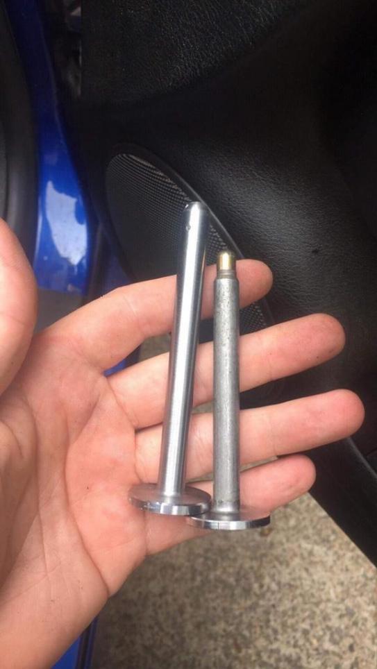

                            • Rod on the right is OEM, rod on the left is the one I made to suit the commodore master cylinder.
                              The rod can easily be made, but like a lot of things, if it already exists it’s often easier to purchase it.
                              • Ok. I was half expecting the OEM rods to be made from a steel/plastic assembly with rods/springs and sockets knowing VAG. If thats all they are then I can do that on the lathe at work no probs. Being the parts guru that you are, you dont happen to have a 23.81mm MC off a Bora V5 do you?
                                I know the MC swap didnt solve your issues RE pedal travel, but with fat pads, new bled fluid, braided lines, tyrol caliper stiffeners, MC brace etc there's not much else left to try on my setup.
