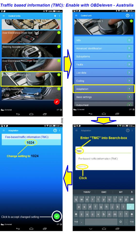

After two months, I finally got my hands on an OBDEleven module (thanks AUSPOST for that). I followed the instructions on this thread to enable TMC, but still nothing
. Does anyone know what's the magic number I should put in?
