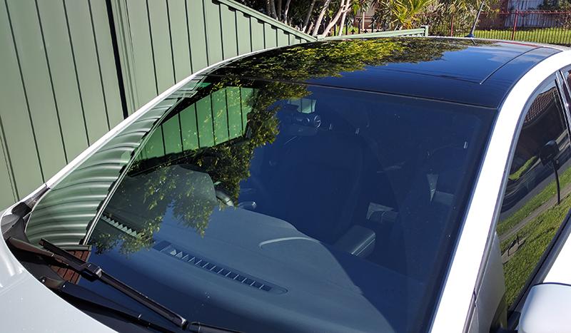

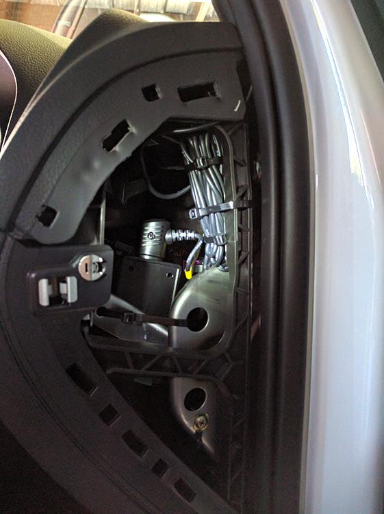

          Here's mine.
          I ran the power cable under the roof lining then across and under the A-pillar plastic cover, then down behind the dash where I installed the power box. All of the cabling is totally hidden, except for the small section that runs down to the camera.

                    Now just a question... in the 2nd image, do the end caps of the dashboard just pop off with trim removal tools ?
                      They sure do, lever them from the front and wiggle them out, takes a few seconds.

                        Looking at the holes in the dash, the cap just comes straight off, does it have to be moved slightly backwards too, is there a hook on the cap that requires it to be pushed forwards when you re-install ?
                        Or is just straight out and off, after manipulating the front (top and bottom) first to get underneath ?
