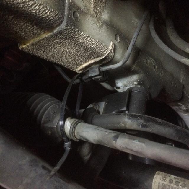

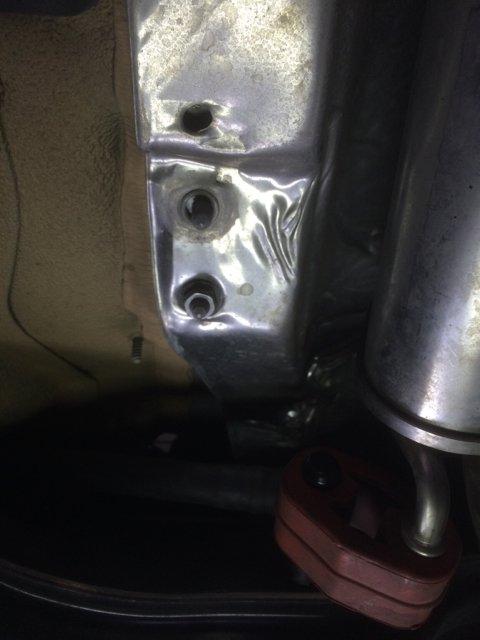

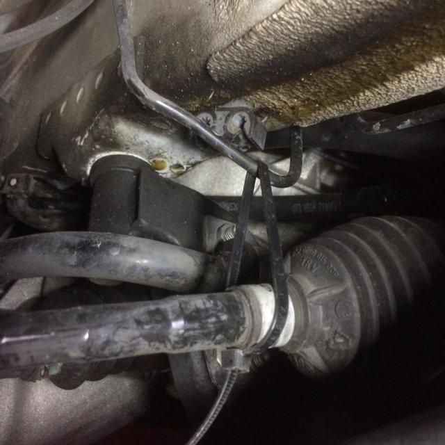

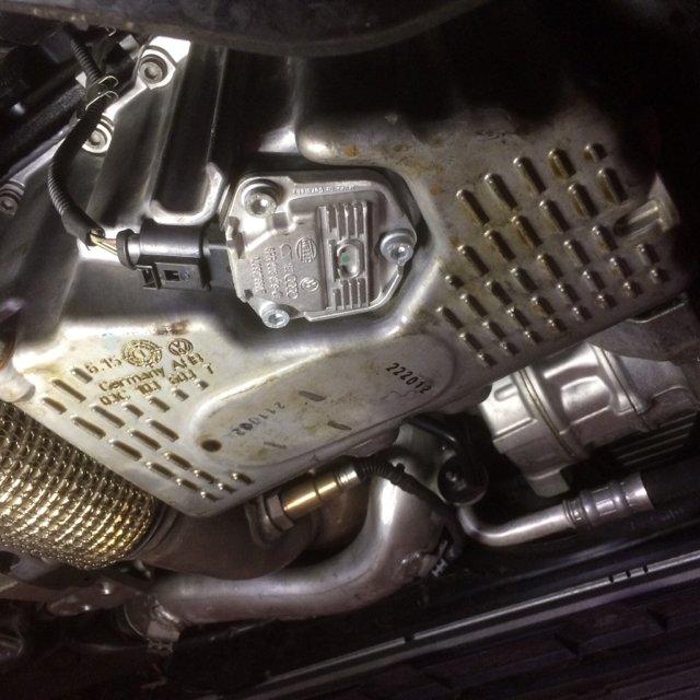

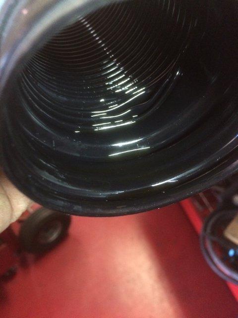

                    • #55
                      6R GTI misfiring
                      The car is now at VW Glen Waverey to check all the work that South Yarra did.
                      When I took it to my independent mechanic last week for a service he discovered HEAPS of loose bolts and missing nuts, a massive exhaust leak, loads of oil under the sump and in the intake, misaligned suspension and cradle, and the suspension was cable tied to the brake lines - and had already pulled one out of its clip.
                      Ben
                      2015 Polo GTI & 2019 Golf R

                        That is disgusting mate have you contacted VW they should lose their franchise over that.. I would also contact Vicroads if they have an RWC license
                        B6 Passat Wagon No KESSY
                        • #57
                          I would be demanding everything is removed and reinstalled correctly and any damaged parts replaced that is beyond shoddy

                            Ben, truly outstanding mate...how can people sign off on work like this!!!

                              Thats beyond horrible, its unsafe. Someone (VWA who should claim from the dealership) should be compensating you for that, if you hadnt had it checked you could have just driven it and been killed. mental.
                              Im really gutted for you that they did such shoddy work, this has been a nightmare for sure.

                                For once, I'm speechless. How/Why/WTF is going on by tying the steering rack to brake lines? [emoji51]
