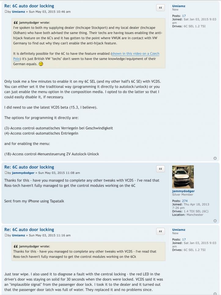

      Auto door locking - pretty easy to do if you have access to VCDS, I got it to work on MY16 polo gti and MY15 polo 81tsi.

          Thanks guys. I haven't got a vcds yet. Was thinking to buy one but wanted to make sure it could do what I was after first.
            So where/what exactly did you update?
              Polo coding - traffic and auto lock
              Access control (3), (4) and (1 in central electronics module, set to active.
