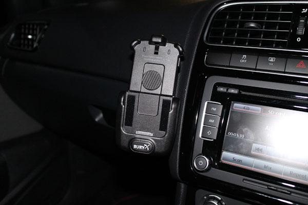

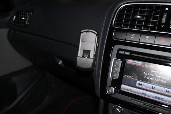

The Attachment that is left on your car when you remove the Bluetooth Touch Adaptor is called a Bury System 9 dock,
These docks are:
- Powered– to recharge your phone
- Connected to the car’s GSM/Phone antenna -> this has come up a few times. Details from Bury's website & experience - however you will want to confirm if your phone will benefit from this if you use the Universal cradle.
- connected to the car's microphone (the touch adaptor uses it's own microphone when connected)
- Not connected to your stereo or MFD other than by bluetooth.
That's right, it does not replace the MDI – and any music played from your phone will be over Bluetooth. MDI still rules for quality,

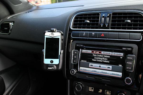

It can have a phone specific dock attached on top of it. YAY!
It can also have a universal dock attached on top
