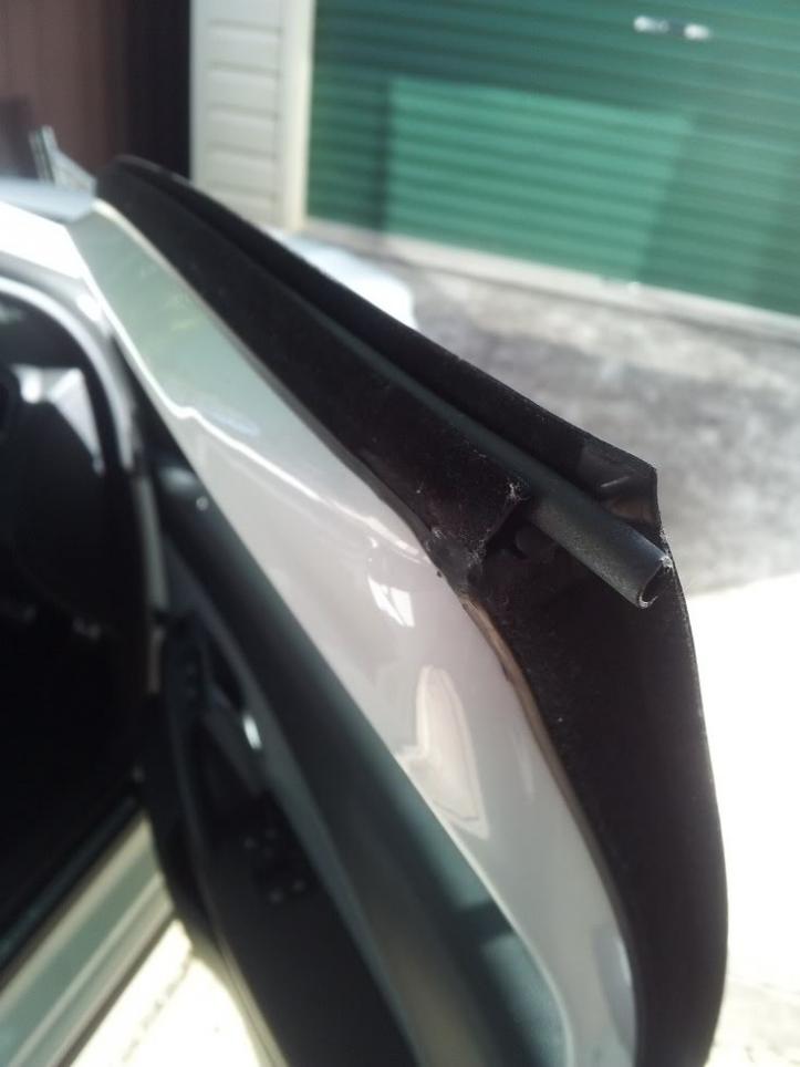

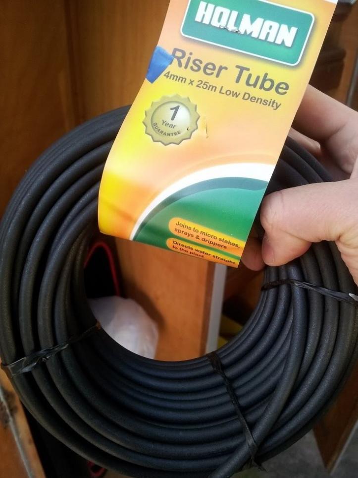

          • I finally got around to fixing the rattling/creaking due to the door felt/rubber. Went to Bunnings last night to pick the 4mm irrigation tubing. Cost me around $5 for 25m.
            And it was as simple as feeding the tubing through the gap between the felt and rubber.
            It's pretty much fixed the 95% of the creaking. A few here and there, but definitely not as noticable and prominent as before.
            Just felt like sharing in case anyone didn't know there was a fix out there for us Polo owners
            Kudos to the gents in the golf section http://www.vwwatercooled.org.au/foru...tml#post837041.
            Polo 6R GTI - Candy White | MY12.5 | 5 dr | Weitec Hicon GT | OZ Ultraleggera | SPOC - 1st Four
            • If you just keep your seals clean when you wash the car and then apply a layer of gummi pledge once a year, your seals will better for it and remain more supple too over the life of the car.
              • I didn't consider the gummi pledge as the guys in the Golf thread said it was more of a temporary fix for the door creak. I do put 303 Aerospace on the rubber and plastics to keep them nice and shiny though.
                Does gummi do the same or should it be another car care product to add to the ever-growing list?
                • It's different to 303. It doesn't really have the shine that 303 gives, it's more absorbed into the rubber. Seriously though, once a year is all you will need to do
