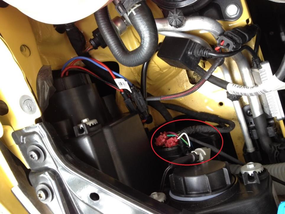

            Is this what you're talking about?
            He had a message with this photo
            The reason that you need to cut the wire because the pin orientation is not the same spec with the light. It is for the corners and the led.
            The wiring isn't supposed to be needed if the pin arrangement is correct for the spec.

              • Interesting...he has previous Polo as well...as you can clearly see the lights are working...but he has the lights on (Parker)
                as you can see:

                          They're designed to run off parkers, that's in Hong Kong (RHD) 2011 S.Africa built Polo similar if not the same as Aus spec.
