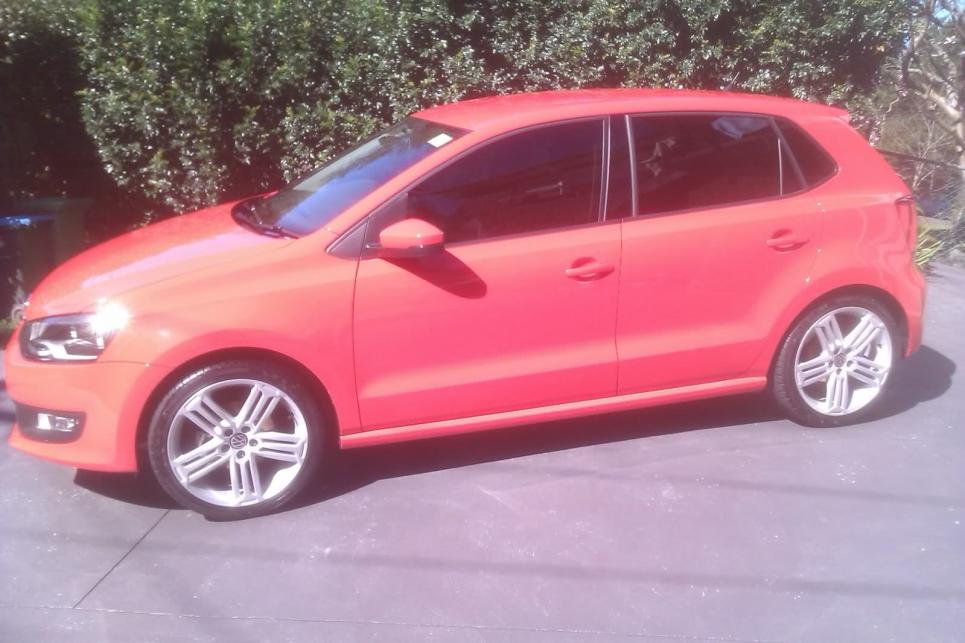

From what I remember you got them to make a 5x100 version?
I actually have a different set of replicas lined up in the next month or so from another wholesaler, can't wait to see them on my Polo. Can't let to cat out of the bag yet though
