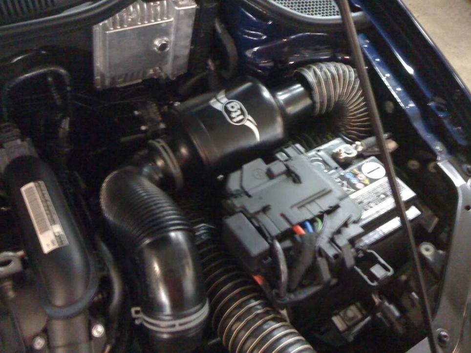

                        Hi all, here is my intake:
                          Cool! Still looks like it has a few bends... Noticeable difference? How much did it cost? Where did you buy it from? Was it custom or actually made to fit into the 1.2 tsi?

                              Yes that's my car. Better pick up noticeably from mid-high end. Cost me 400+SGD . Got it from apdrive. Mine was the first polo to be fitted with itg locally so you can say that it's custom fitted.
