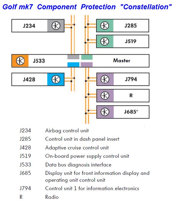

        hmm........ I would suggest that you seriously consider doing a heap of research on this project before spending any money.I don't think that you will have CP issues with the hex01 module - if the polo uses the same arrangement as the Golf . These are the modules and the CAN arrangement for what VW calls the CP "constellation".
        Notice that J623 (the engine module) isn't in the picture.
        But it's entirely another question as to how the Golf 1.4 92KW engine will run on your existing ECU -and if you change the module, how well the (foreign) Golf ECU will be accepted by the rest of the native modules on the Polo CAN network. It's certainly an interesting problem - I don't have any answers, but my advice is to be informed before committing cash (through research)
        Don
          CP isn't involved, however the ECU is part of the immobilizer scheme, so it needs to be adapted along with the keys using ODIS online before the car will start.
