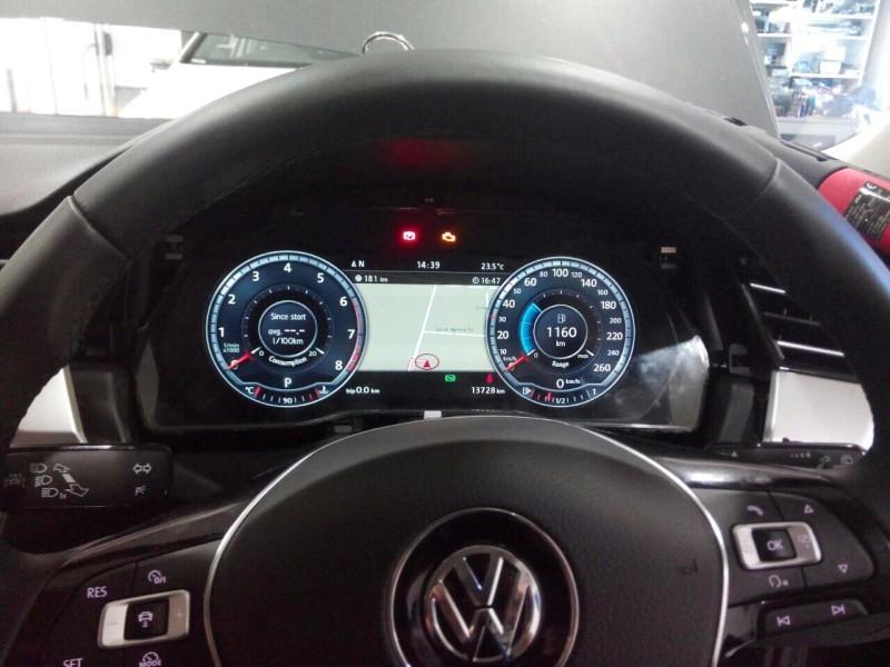

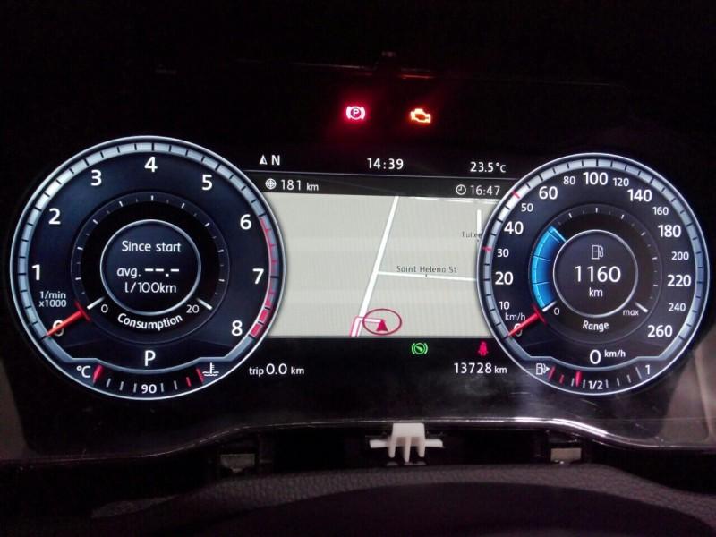

    The Passat B8 Cluster Upgrade has been successfully completed now by Euro Car Upgrades for Stu.

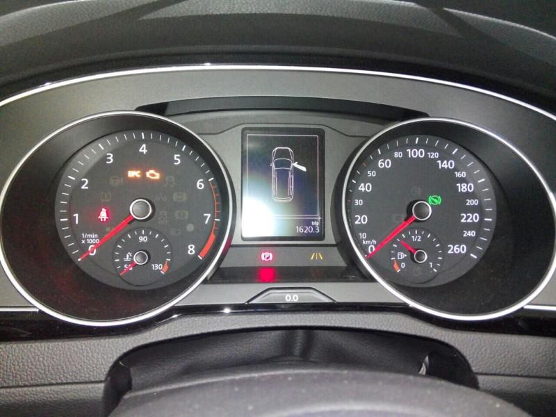

          Some people prefer analogue but this one looks awesome on a Passat when you put it side to side.

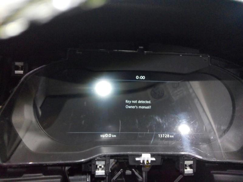

          Installation was a hard one, especially the coding. All the modules speak to the bloody thing and need to be recoded.
