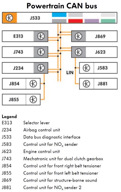

There are a gazillion different TLAs (Three-Letter Acronyms) used in the language of vehicle technology - so its not unlike every other field of endeavor in the modern age!! The TLAs below might help in your understanding of these responses
- TCM = Transmission control module
- ECM = Engine Control Module
- ECU = Engine Control Unit
- PCM = Powertrain Control Module
So, ECM and ECU have ostensibly the same meaning. TCM is sometimes called the "Mechatronic Unit/Module" on dual clutch gearboxes. PCM is mentioned in the U010000 error (Lost Communication with ECM/PCM). I suspect "Powertrain" when used in the context of the error message refers to the combination of ECM and TCM. However, on a MQB platform car like this Passat, separate modules are used to control the engine and the transmission - and the term "Powertrain" has a particular meaning; it relates to the "Powertrain CAN bus" which looks like this:
