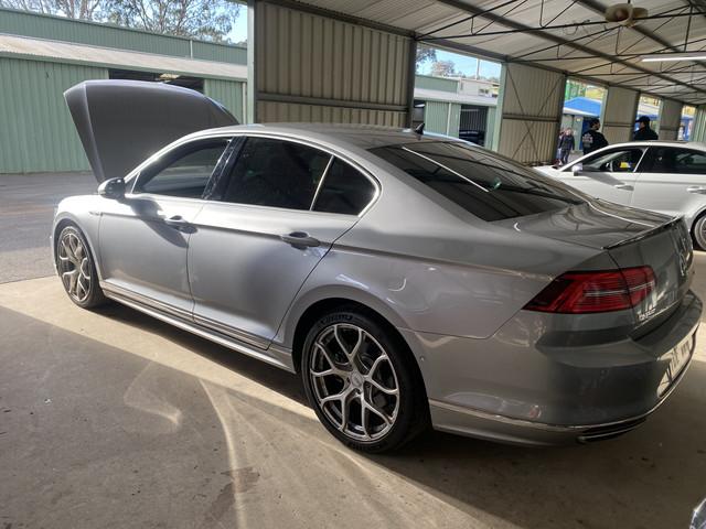

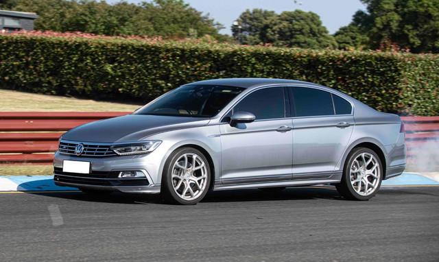

                      As others have suggested, been running 245/40R19 Michelin Pilot Sport 5's on my stock 206tsi wheels with no issues for over 12 months now. Went with a 245/40 as they're a very common size compared to the stock 235/40 and much cheaper to purchase. They're wider and the sidewall slightly taller than the stock 235/40's, but they're more comfy, don't rub at all and there's barely any changes to the speedo. No brainer imo.

                        Awesome, thanks for that green_comet. I held off the 245/35/19 RE003s as I found a much better deal for Pilot Sport 5's in 245/40/19. I'm keen to see how they perform!
