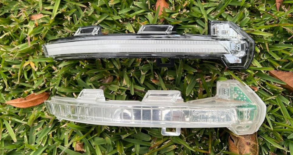

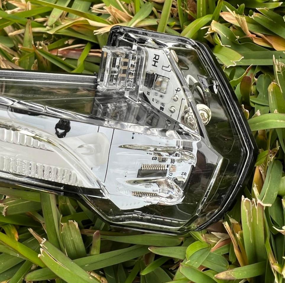

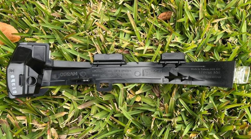

    The build quality of the OSRAM item is excellent - truly OEM quality or better. Perfect fitment, plug and play.

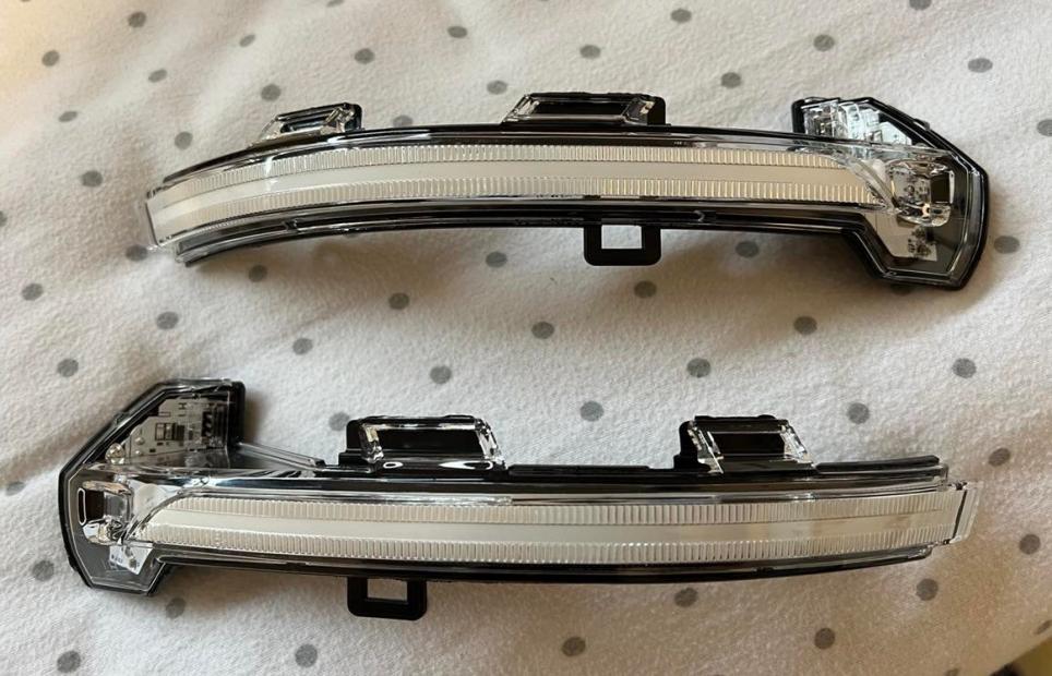

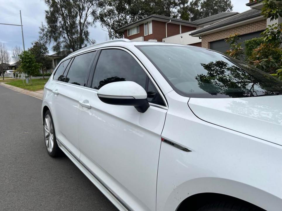

    And some photos:

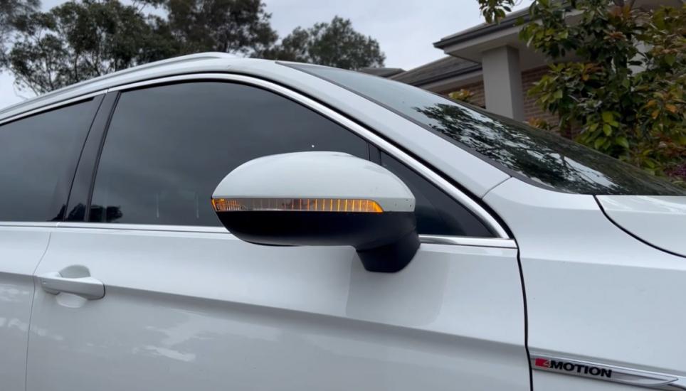

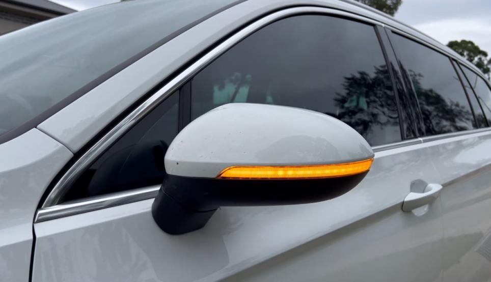

    OEM vs OSRAM
    Original brightness:
    OSRAM brightness:
    OEM quality fitment:

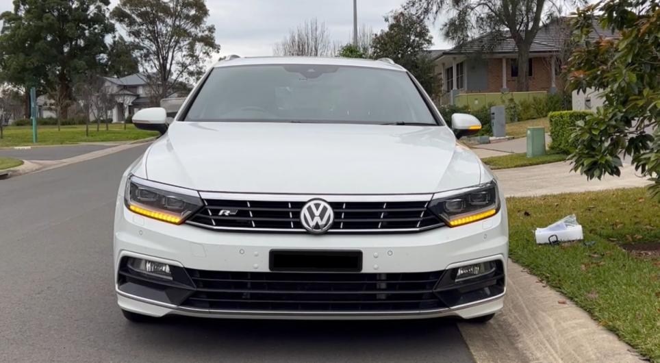

    Comparison (original on driver's side and OSRAM installed on passenger side) - you can see how the intensity of the OSRAM mirror LED is a very good match for the front headlight indicator sections, whilst the original mirror LED is significantly dimmer in comparison:
