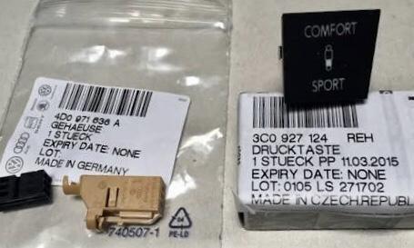

    Here maybe? Schalter Mittelkonsole | Passat3c.info - powered by Contrexx Web Content Management System
    Edit: here's one on ebay; For VW Passat B6 CC OEM Rear Window Power Sun Screen Roll Up Switch Push Button
    Would be nice with one for Passat B7.
    132TSI Tiguan Allspace
    • #47
      Originally posted by Vr32wa View Post
      Hey mate, where did you order the buttons to replace the blanks?
      I actually i ordered another one as the first one took ages and as a result i have a spare here in my hand if you want it.
      MY10.5 Candy White VW Passat .:R36 Wagon
      3.6L VR6 Petrol 220kW 350Nm
      RVC . 9w7 Bluetooth . OPS . MK7 Climatronics . Sunroof . Dynaudio Upgrade . RNS510 . 18" Alloy Wheels
      • #48
        I'll definitely take it
        • #49
          Originally posted by BrendanMK View Post
          Having the blank buttons there was killing me, first one arrived today ready to be hooked up to my garage door opener (write up to come when i have the time)
          The second is still in transit (will just be wired up to light up - no other purpose) and will be the suspension adjust button pictured below.
          Now that you've got the button I can't wait for you to tackle the DCC (Dynamic Chassis Control) retrofit! Even Kamold hasn't attempted that one...
          Biscay Blue MY10.5 Passat R36 Wagon
          Options: Sunroof, RNS510 Sat Nav, Dynaudio, Power Tailgate, ACC, RVC, BT 9w7, Tint and Factory Towbar.
          Atlantic Blue MY19.5 Golf GTI
          Options: Luxury Package and Sound & Style Package.
          • #50
            Read the post again, no way i’m attempting that. Just giving it power so it lights up with the rest of them. ill have my work cut out already with the garage opener [emoji23]

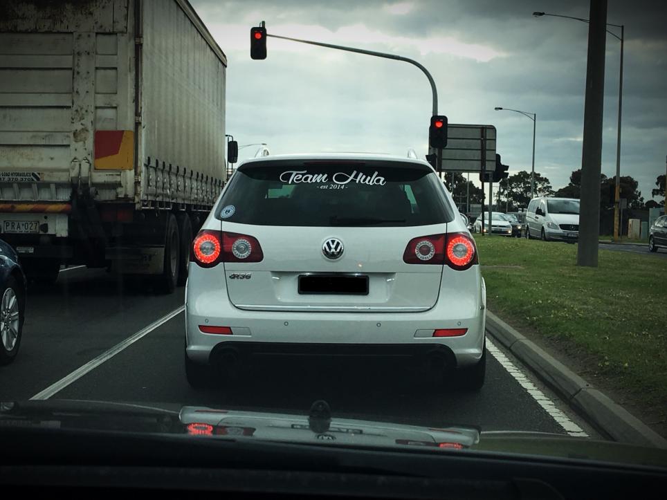

                  Just a couple of little VCDS tweaks i’ve done recently:
                  Tail light ring mod (disabling centre section when parker lights are on - still at 100% brightness when brakes applied).
                  Easy entry enabled on drivers side only.
                  Full interior LED replacement with relatively dull bulbs - don’t like super bright interior lights. still trying to work out how to disable footwell brightness while door closed/driving, currently at 100%
                  Rain closing feature enabled for sunroof and windows.
                  Lengthened the time the HVAC screen is displayed when changing temp etc.
                  • #54

                      Brendan's Candy White MY10.5 Passat R36 Wagon
                      Before and after [emoji5]
                      Rain closing is when you leave windows and/or sunroof open while parked and locked it will automatically close them when rain is detected by the RLS. Saved me once already in Melbourne’s bipolar weather.

                        i'll check mine as i am fairly sure that it looks like your 'after' when the park lights & headlights are on (typical of the 'first stage' in any normal tail light according to ADR)..
                        have you enabled the Emergency braking light sequence?
                        above 100km/h - stand on the brakes - if flashes the brake lights at 100 % strobe a few times and adds Hazard warning lights.. i wish it did this at a slightly lower speed though - maybe 80km/h and above?
                        Deep Black Volkswagen R36 Variant MY09
                        Opts: Auto Tailgate, Bluetooth, Sat Nav
                        Mods: OBD11 apps? It needs some
                        YouTube: That Car Channel
                        • #57
                          If you haven’t touched it both outer ring and inner section will be around 20% brightness as parker lights. I’ve simply disabled the inner section as parker light and left the outer section as is. Then when you press the brake pedal the inner lights up at 100%
                          Emergency braking flashing sequence is active from anywhere above 40km/h i’m told. you just really need to punch it at a lower speed to get it to flash. My MK5 golf did it at 50km/h confirmed if you really give it a push.
