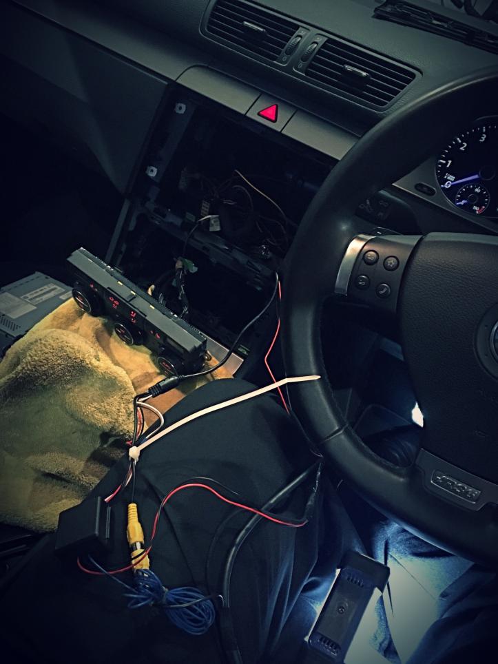

      Bit of work wiring up the RCA camera to the factory RNS510 unit using a triggered relay for powering the camera and the converter box to go from RCA to the factory multi pin plug.
      RCA cameras allow for a higher quality image over the factory cameras and a wider angle, again without sacrificing the quality.

            does not look like an OEM camera, maybe thats why it does not wok

              working beautifully now [emoji1362]
              process of elimination found a found a fault with the supplied loom. independent RCA cable fixed the problem.

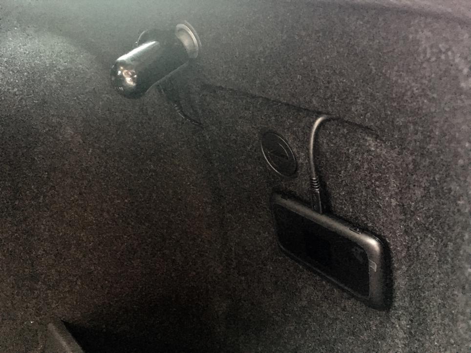

                            4GX WIFI dongle installed ready for the Blackvue cloud camera to go in on Wednesday.
                            Just takes data from my 38GB/month phone plan at no additional cost so that's pretty good seeing as i don't use anywhere near that anyway.
                            With the camera wired in to the PMP and the dongle with a battery life of 4 days i should be pretty safe [emoji1362]

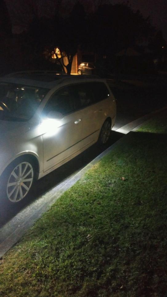

                              Keeping to the stock look i upgraded the number plate lights, puddle lights, front parker lights and footwell lights in the 36.
                              Having it still look stock whilst getting rid of the yellow glow from the various halogen bulbs really cleaned it up nicely imo.
