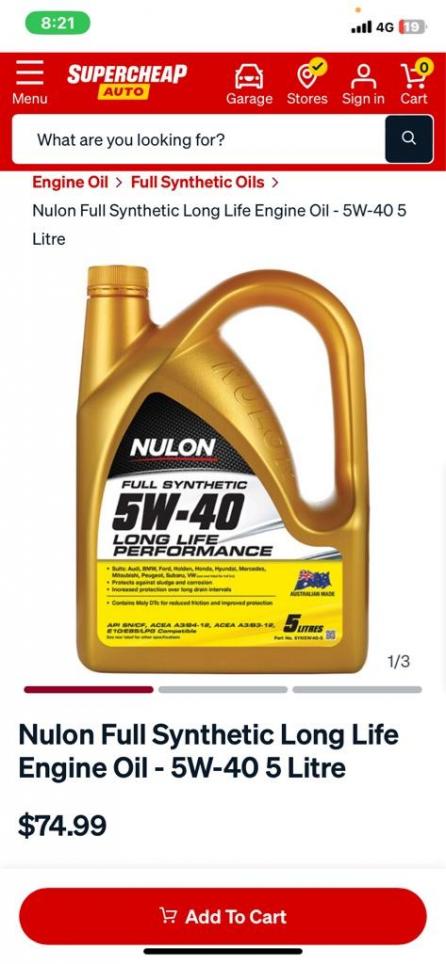

          Okay. Can I use 5w40 as a top up even though it was serviced with 5w30?
          Cheers!
            also. Cant seem to find any 5w40 with VW approval 504/507
            Hope this thicker oil can slow down consumption. Not really keen on replacing piston rings or valve steam seals.

              The reason that you can’t find 504/507 spec oils is that that specification is 5w30 and it is designed for Europe. You will not find a 5w40 or 10w40 but you will find it in 502/505 VW spec

                Ok thank you. Will try the 5w40 nylon this week and see how I go.
