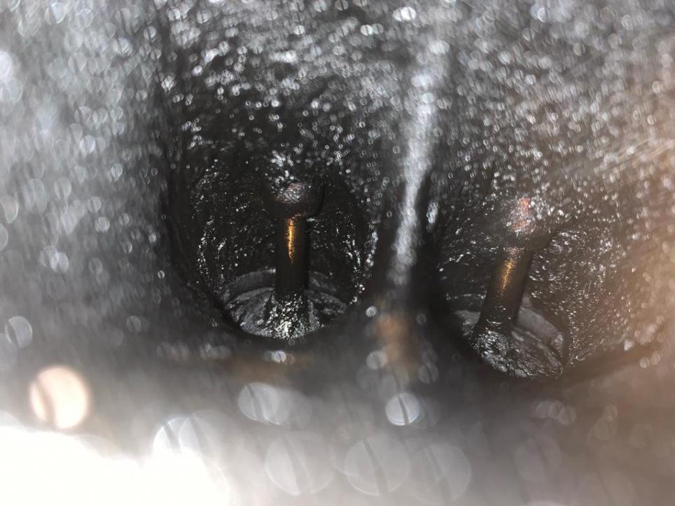

        Wait till you see the intake ports
          Wow that is bad, i cant remove the 1nd lower part of the manifold due to access and draining the fuel rail. but will try to get camera in some how.
